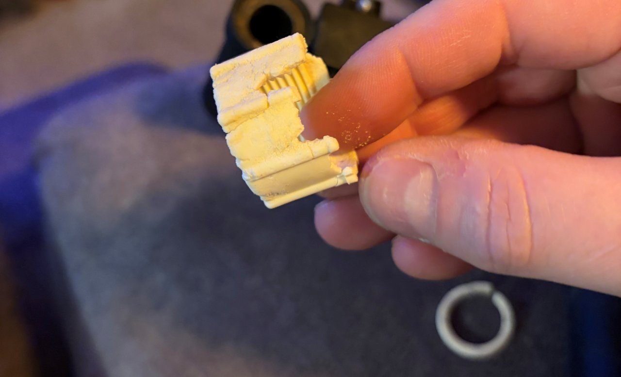

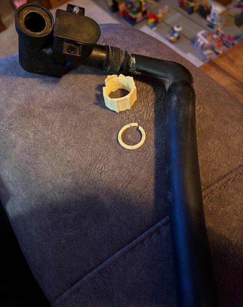

Noticed my ICOS24 boiler was dripping from the rear right area of the lower plate a few days ago. Isolated the power and called British Gas in to take a look.
The engineer found the issue, a corroded plastic nut that holds the condensate drain rubber hose to the S-trap.
I was amazed as to why this had corroded, i thought the whole idea of the S-trap componets being plastic/rubber was to avoid corrosion caused by the acidic nature of the condensation. BG engineer said he had not seen this before and couldnt explain it.
He fitted a new trap and rubber hose, the old S-trap was quite gunked up with small black metal parts (apparantly)
Any ideas?

Probably 20 years, think it’s the same boiler from when the house was first built
+1, that's not really corrosion. The large number of heat cycles and the amount of time that it has been in service, then the plastic has slowly broken down. It is rare but I have seen it a couple of times before.
It's almost like the same process that PP/PB goes through when outside and UV breaks it down over a long time, it seems to end up in the same brittle/powdery way.
