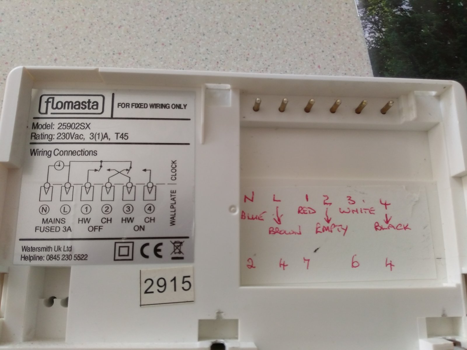

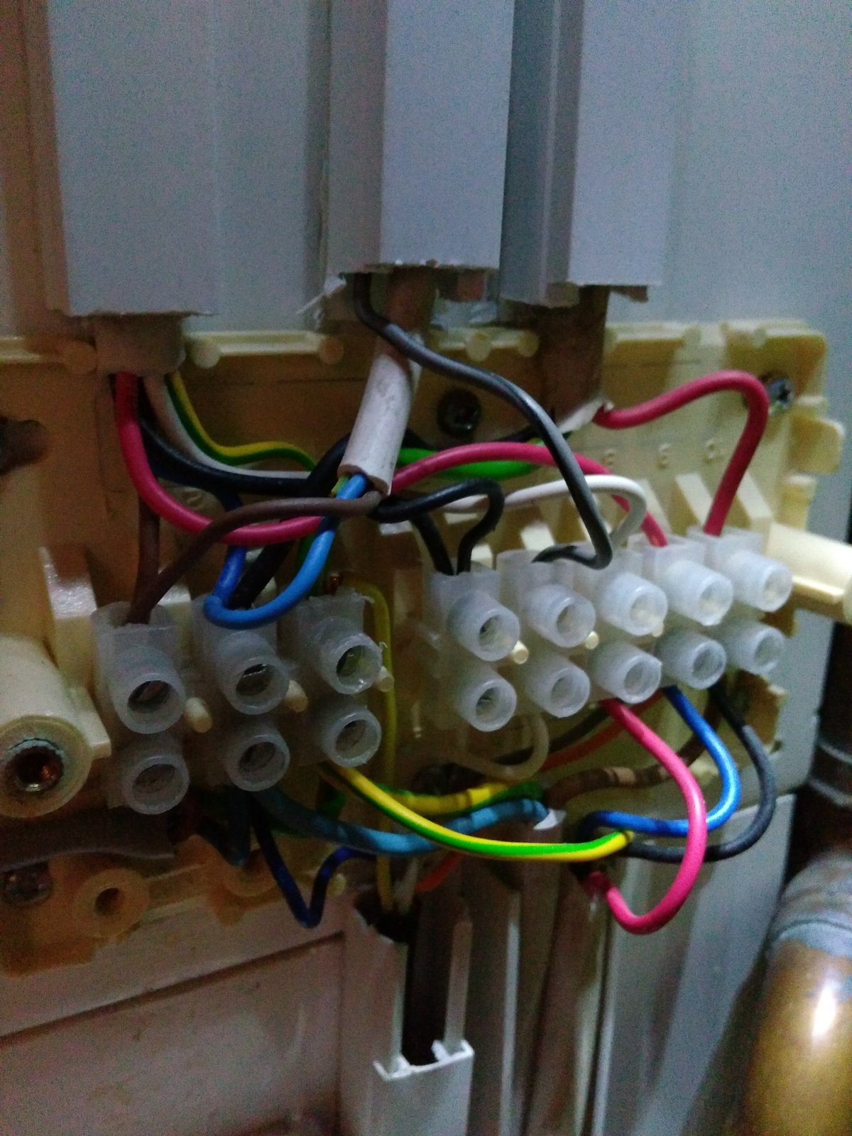

    Hi sorry but I am back again, the boiler is a Ideal Classic RS40, I installed it over 25 years ago and it worked fine for a good few years. Things packed up over time IE: room stat, programmer, 3 port valves etc. Recently I had to replace all the electrical inners due to being plastic in a hot area IE: Gas control valve, Piezo unit, Gas control valve, etc. I checked all the wiring to make sure all was "I HOPE IN THE RIGHT PLACE" I also replaced the 3 port valve as the heat was not working. After all this only the water would work, the heating would only work if I pushed the manual lever over. I am only doing all this as at 82 I cant really afford a new boiler. Plus I would need to change the whole kitchen to accommodate it. Any help before I blow my brains out.

    Most likely that you have not wired the HW off circuit on your 3 way valve properly, post pics of everything , should be an easy fix if it originally worked

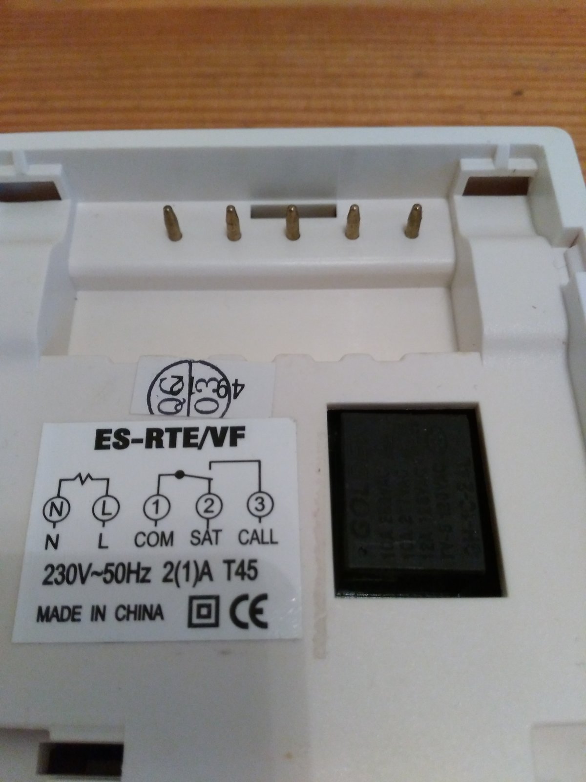

    HI Ian, sorry for the delay, son's as much good as a chocolate teapot. the wiring is as follows, number 1 in junction box has 3 brown wires IMG_20190913_154246.jpg IMG_20191205_145729.jpg IMG_20191205_145839.jpg IMG_20191205_150222.jpg IMG_20191205_150304.jpg IMG_20191205_150329.jpg IMG_20191205_150341.jpg IMG_20190913_154246.jpg IMG_20191205_145729.jpg IMG_20191205_145839.jpg IMG_20191205_150222.jpg IMG_20191205_150304.jpg IMG_20191205_150329.jpg IMG_20191205_150341.jpg 1 IMG_20190913_154246.jpg IMG_20191205_145729.jpg IMG_20191205_145839.jpg IMG_20191205_150222.jpg IMG_20191205_150304.jpg IMG_20191205_150329.jpg IMG_20191205_150341.jpg IMG_20190913_154246.jpg IMG_20191205_145729.jpg IMG_20191205_145839.jpg IMG_20191205_150222.jpg IMG_20191205_150304.jpg IMG_20191205_150329.jpg IMG_20191205_150341.jpg IMG_20190913_154246.jpg IMG_20191205_145729.jpg IMG_20191205_145839.jpg IMG_20191205_150222.jpg IMG_20191205_150304.jpg IMG_20191205_150329.jpg IMG_20191205_150341.jpg from main feed 1 from programmer 1 from room stat. Number 2 in box has 6 wires 1 black from boiler 5 blues, 1 from room stat, 1 from programmer, 1 from main feed, 1 from pump, 1 from 3 port valve. Number 3 in box all earths, from 3 port valve-boiler-programmer -pump-main feed- and tank stat. Number 4 in box 1 black from room stat 1black from programmer. Number 5 in box 1 white from 3 port valve 1 grey/black from room stat Number 6 in box 1 white from programmer 1red from tank stat. Number 7 in box 1 red from programmer 1 grey from 3 port valve 1 blue from tank stat. Number 8 in box 1 red from boiler 1 brown from pump 1 orange from 3 port valve.

    • HI Ian, sorry for the delay, son's as much good as a chocolate teapot. the wiring is as follows, number 1 in junction box has 3 brown wires 1 from main feed 1 from programmer 1 from room stat. Number 2 in box has 6 wires 1 black from boiler 5 blues, 1 from room stat, 1 from programmer, 1 from main feed, 1 from pump, 1 from 3 port valve. Number 3 in box all earths, from 3 port valve-boiler-programmer -pump-main feed- and tank stat. Number 4 in box 1 black from room stat 1 black from programmer. Number 5 in box 1 white from 3 port valve 1 grey/black from room stat Number 6 in box 1 white from programmer 1 red from tank stat. Number 7 in box 1 red from programmer 1 grey from 3 port valve 1 blue from tank stat. Number 8 in box 1 red from boiler 1 brown from pump 1 orange from 3 port valve.
