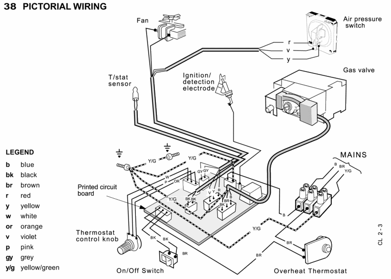

Is there a supply on the fan connector at PCB ('Molex' marked 'FAN')?.
There should be live at both terminals of the high limit thermostat and at the purple wire to the air pressure switch.
There's a fuse on the board too.
Be careful, use a meter and not a mains test screwdriver.

The flow diagram still requires me to check supply at the fan connector. Where is that? and then (assuming 'no') i need to "Remove the sensor(NTC) from the PCB". What's that all about?
The only thing that I noticed was that when it did switch on OK, the component on the PCB that is arrowed flashes. I assume this is normal?
http://www.hpjw.co.uk/temp/pcb.htm

See, the grey wires go to the fan.
The flashy thing is supposed to flash when it sparks.

It started working again when I tapped the black box in the top right of the PCB. Pic here: http://www.hpjw.co.uk/temp/pcb2.htm. Coincidence? I'm not sure. What is this black box? Does it have any moving parts? If not, it may be another red herring
When it wasn't working there was no power to the fan. So that takes me to this in the diagnosis tree: "Remove the sensor(NTC) from the PCB".
Are they talking about the thermostat sensor?
http://i30.photobucket.com/albums/c321/ChrisPlumber/Ideal-Classic-FF-pcb.gif

Fan relay on the PCB - I can see it from the photo
and as someone who repairs them, I can tell you it's the single most common fault with the 25B PCB
The thing which sparks is the spark gap ... that's what it does
the black thing is the HT transformer, the soldering might have cracked on the underside of the board
get thesel' a recon pcb

It looks like it is that little black box. The next time it stopped, it started again on tapping it again.
I'll check the solder connections and if there's nothing to re-solder, I'll get another PCB. I can get a second hand one for £28. Is that an OK price?
