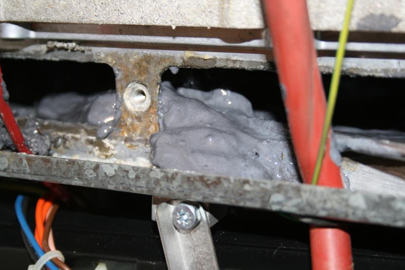

If the condense water backs up the flue gasses can't get away properly and you get poor combustion.
Condensate will be backed right up overheating it and distorting the seal allowing it to leak into the combustion chamber, bet you get a scary co reading when you stick the flue gas analyser round the back of th burner aswell.
It often kills the gas valve too as the water leak goes down the breather pipe idirectly into the valve.

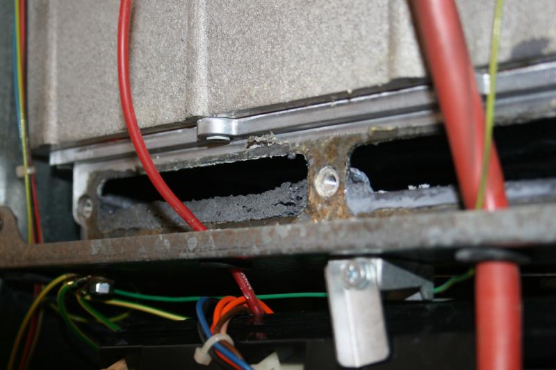

Yep, as said, take the trap off clean out, preferably using a small screwdriver, flushing won't clear everything and clean the sump, especially to the right hand side where the flue is connected.
It doesn't look anything like as bad as those pics, but sounds like you guys are right, hopefully the gas valve is ok, but is not it's another 80 quid gone :?
90% of L:F faults on these are due to lack of PROPER servicing and blocked trap/sump :wink:
Had the trap off and scraped some serious crap out of there, was rock solid, checked it and it's flowing well, the pipe connected to it was clear.
One thing I'm not clear on, what is the sump?
The plate along the bottom of the HE that is held in place with 3 screws. It says on it ' do not remove unless trap is drained and removed ' or similar.
Oh, one more thing to cheer you up, all that carp in the trap and the sump is your HE being corroded away by the condensate :shock:
Nice one Ideal, or any manufacturer that uses aluminium HE's :roll:
Sorted, my mate wasn't sure, and I wouldn't have had a clue.
