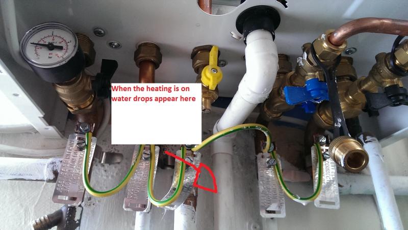

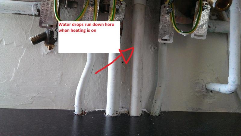

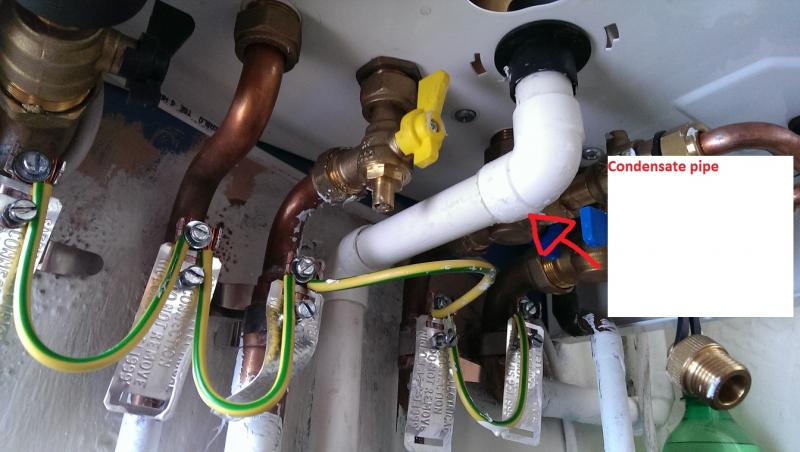

I have the above boiler. Water keeps dripping down the plastic condensate pipe when I have the central heating on.

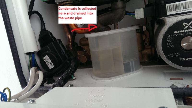

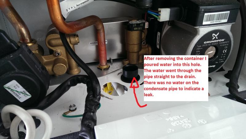

I have taken the front of the boiler off and removed the condensate container/trap and poured coloured water down the condenser pipe to see if there are any obstructions or leaks. The water went straight down the pipe to the drain, so no obstructions, but the coloured water did not appear on the outside of the condensate pipe. The leak only appears when the heating is on.
Any ideas?
condese trap leaking ? ( the wiring to that boiler have a load of tape over them that doesnt look to good )
If its dry before the point you indicate either one of the glued joints have gone or the pipe/fittings cracked. The cover of this model also makes it room sealed, you shouldn't remove it.
