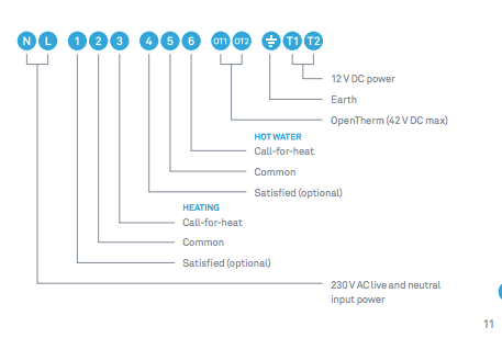

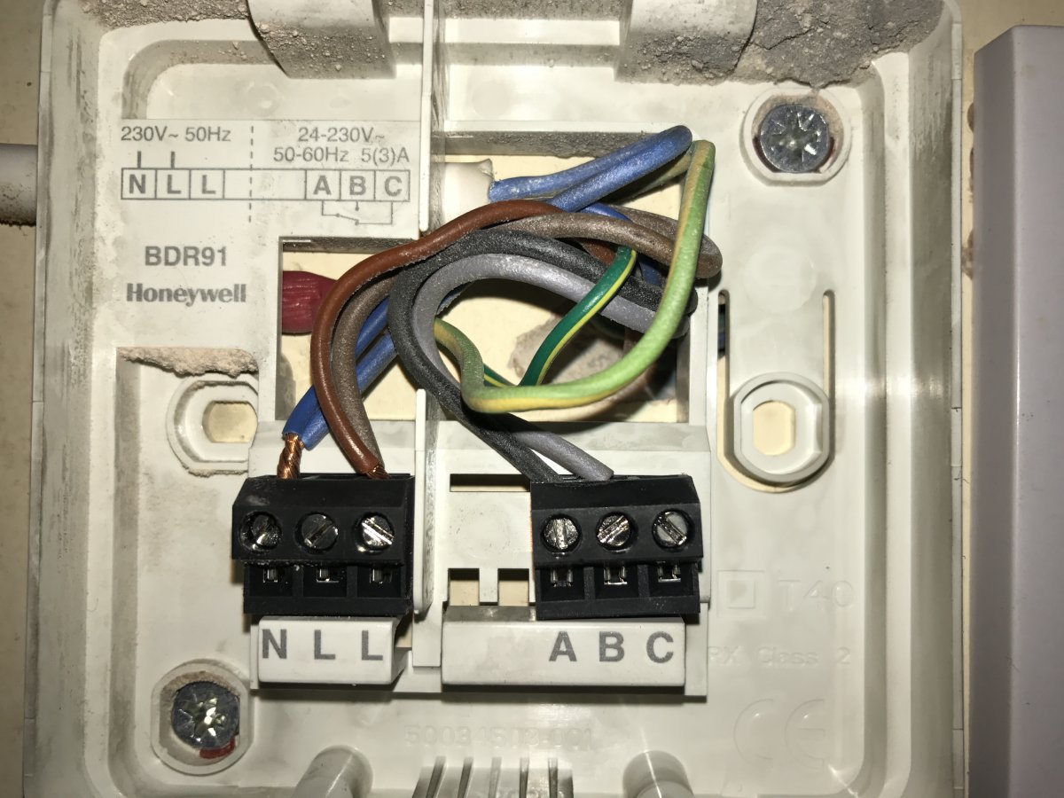

I am buying a Nest 3 thermostat system to connect to my Ideal Logic Combi 24. I thought it might be a relatively easy matter as the system is already fitted with a wireless system in the form of the Honeywell CM900 system (to be exact a CM927 system thermostat wirelessly connected to a BDR91 relay box).
Included is an image of the present connections to the present relay receiver box. Two blue leads (neutral) are attached to the N connector and two brown leads (live) are connected to one of the L connectors. I suppose these are from the mains to the boiler via this box.
In addition, a black lead is attached to the connector labelled A and a grey one to connector B. I expect these are for switching the boiler on and off.
From this, could someone please let me know to which of the connectors on the Nest 3 receiver (the Heat Link) I attach these latter two wires (please see included sketch of Nest Heat Link) from connectors 1 to 3? I imagine that the doubled-up neutral and live leads go to the N and L connectors of the Nest receiver as before?
I hope that the other wires visible, but not connected (e.g. the earth leads), in the present relay box remain unattached.

You have worked out that the wires that go to N & L need to remain exactly as they are.
Then if you look at the diagram inside your existing thermostat the switching wires are 'A' which can be seen to be the common (in that it can make contact with both B & C) and 'B' is shown as the call for heat contact, also confirmed by the existing grey wire being connected to it.
So, you simply need to connect them to exactly the same terminals on the Nest. Heating 'Common' (2) and 'Call for Heat' (3)
As you have a combi, you won't be using the hot water functions.
There is an earth terminal on the Nest, so you should put the earth in there.
