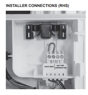

Can someone advise if the Ideal Logic H12 is OpenTherm compatible please. On the ideal site it says it is, but with Evohome. I also read somewhere I need to install some OpenTherm interface controller into the boiler. What would this be if so?
If I can go OpenTherm, is it worth the cost. I am interested in going the Smart thermostat route and at the moment researching options.
I looked on my boiler.com and it does list logic system as compatible, but not the actual logic model. Would this mean all logics should be compatible? I can’t see any info on Ideal website so I am presuming the answer is no.

According to the Installation Instructions for the Logic Heat H 12 15 18 24 30, it does have terminals marked Opentherm, but no mention of them in the text.
The diagrams below it in the manual just show a standard 'S Plan' and 'Y Plan' which because the microswitch in the motorised valves that controls the boiler is just a simple on / off switch it is wired to the 'Switched Live In'.
I have only ever connected OT to controls for Combi boilers. My understanding is that OT doesn't work with S Plan or Y Plan because it doesn't know which motorised valve the demand for heat has come from it. It could be the hot water or (one or move) heating zones.

Stem, thanks. I would concur that with 2 zones, the control algorithm wouldn’t work. How would it know which zone needs to ramp. Of both were calling for heat but at differing temps, the boiler can’t distinguish on one loop.
I will forget about Opentherm and just focus on choosing the best thermostat.
