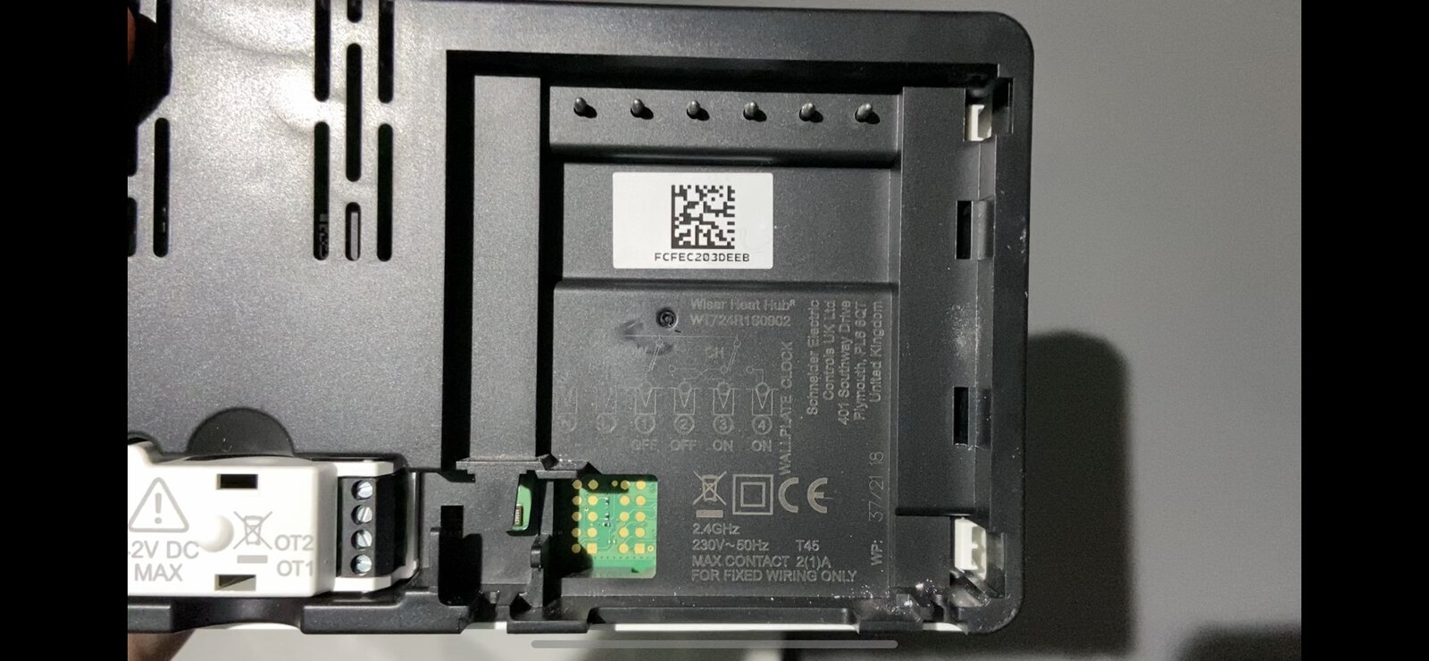

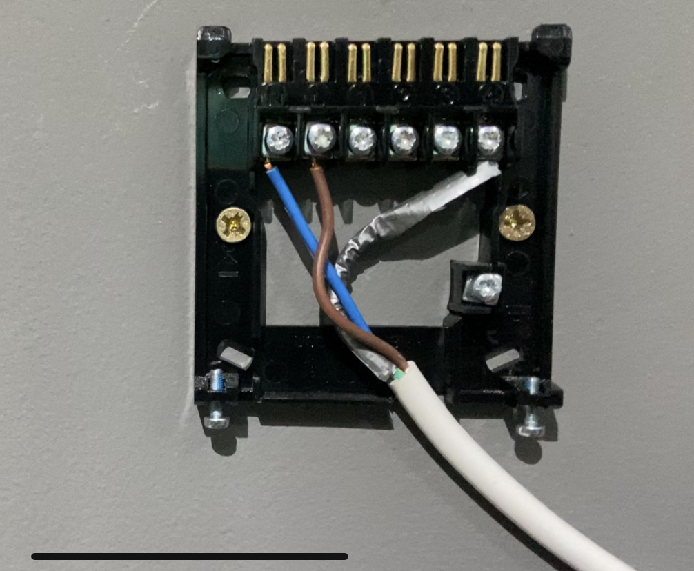

Last year I had a new combi boiler installed alongside the Drayton Wiser smart hub system.
This is the boiler: Ideal Logic Combi Boiler
This is the controller system: Drayton Wiser Kit 1
I didn't know at the the time that the installer could wire it NOT using the OpenTherm module. I want to know if rewiring it using the OpenTherm module is something I'm capable of so I can at least feel like I've done everything to benefit from the technology I've bought.
My experience of electrics goes as far as wiring sockets and lights. If someone could tell me what wire to put where (and perhaps why), I'd be so grateful.
Here's the guide from Drayton, which I'd follow if I knew what it meant by "Set the OpenTherm cables into..." (Which ones? Live + Neutral?)
I've attached images to show how the system is currently connected.
Thank you in advance!

you cant with that set up you need 4 cores
That explains my confusion at least.
So if the 4th core was there, presumably it would go into the OpenTherm module, but which of the existing cables would also go into the module?
As @ianmcd says, an installed unit needs line, neutral, and earth to power it, and then also either OpenTherm or on/off wires to send info to the boiler, over sleeving green/yellow is down to the full stop in the regulation, I would say not permitted, but down to command of the English language, but this is only questionable where you have multi multi core cables, installed devices must have an earth wire available even if not used, since 1966.

Is the boiler working OK at present using the Wiser? I would have expected links to L, N, 1 & 3 on the wiser back plate. Then in addition a separate 2-core cable from the opentherm module to your boiler's OT connection. That said the Wiser installation details for opentherm are not very specific. I think you contact Drayton for advise before doing anything.
Assuming the OT module is not in use at present, how is the Wiser Hub instructing the boiler to come on for CH?
I'm going to go out on a limb and say it's not working with Wiser based on that photo, unless there's a new "wireless" mode I don't know about!
Needs the L&N to power the hub (already in place) and for OP's benefit either the 1&3 terminals (relay switching) or 2-core to the Opentherm module - no need for both AFAIK. Make sure the Opentherm cable is not connected to 230V on either end, or you'll let the magic smoke out.
The 2-core Opentherm cable needs to be connected as shown on Page 32 in this Install/Service manual:
Note the Link Wire on the 230V side of the boiler, which might have been removed if it was setup for a timer.
It's a two channel Wiser, the current wiring would work.
OP says it's kit 1, which is single channel and correct for a Combi.

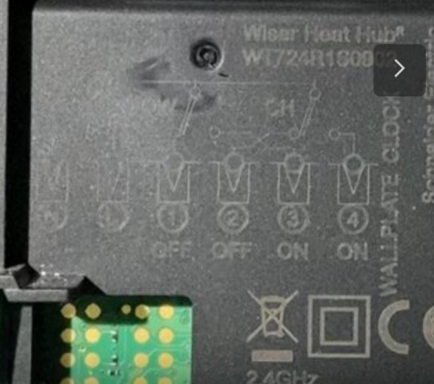

@DDew you've just got a Setup button and a Heating button on the front, right?
If that's a photo of the back of the Ops Wiser Hub, it's a 2-channel version as the model number is WT724. The 1-channel would be WT714. Plus the diagram below the model number shows two sets of channel connections.
When I looked at the photo I thought the "Earth" core had been taped over to isolate it, if its connected to #4 then it would work. It would be nice if the connection to #4 had some proper sleeving.
Ahh damn, I made a mistake. Three buttons Setup, Hot Water, Heating. Guessing that makes it 2-channel? I was wondering if the wiring was wrong how I've nevered noticed :rolleyes:
So sorry for wasting your time.
But basically still if I want to use OpernTherm (even if it won't be worth it) I'd still need someone to replace the cable from the boiler to the hub, correct? Which means unless someone jumps in raving about it, I probably won't bother.

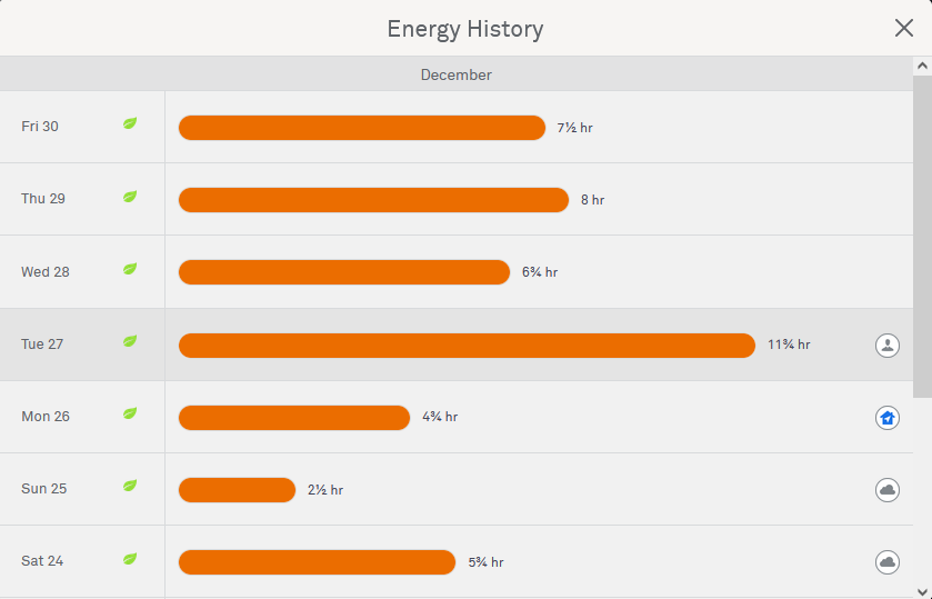

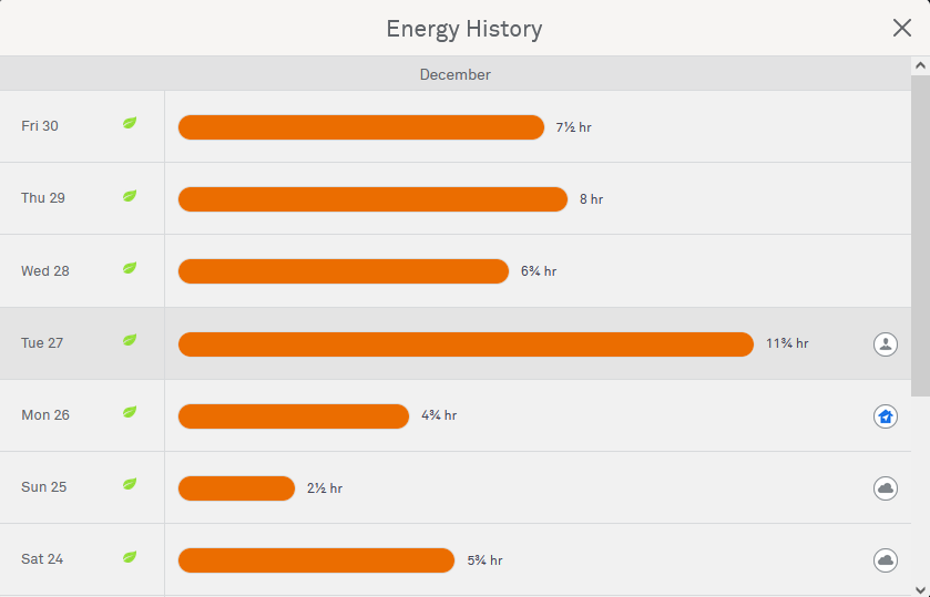

I have seen many central heating systems which work, but not correctly, what would be interesting would be to see the real advantage of using OpenTherm, I know my boiler is switched on by the wall thermostat and stays switched on for hours, 1672480881524.png but this is rather a useless energy history, as although boiler is switched on, it is internally cycling on/off (oil so does not modulate) with gas the return water temperature can modulate the boiler, so as long as the thermostat is not cycling the boiler, it should do some thing similar to what it does with OpenTherm.

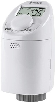

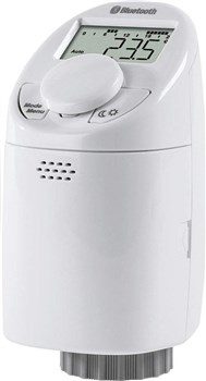

The amount the boiler modulates may vary OpenTherm to return water temperature, but not sure by how much? However for the OpenTherm to work the master controller (Wall thermostat in your case) must connect to all the TRV heads and correlate the information, this means every TRV needs to connect to the wall thermostat, however Wiser TRV heads are expensive, so the normally method is to select key rooms, maybe living room and master bedroom, and have the TRV's in these rooms connect to the thermostat, but in other rooms use much cheaper heads like these EQ-3 Bluetooth Smart Radiator Thermostat.jpg which are still programmable, but don't connect to the main wall thermostat, I paid £15 each for mine in 2019, these will not cause the boiler to fire up, but will alter the temperature of the return water, so will cause the boiler to modulate.
So if you have all Wiser TRV heads connected to the main thermostat then maybe the cost of getting the correct wall thermostat would be worth while, but if some TRV's are not linked, then maybe better left as it is.
