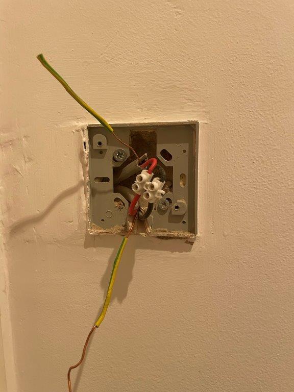

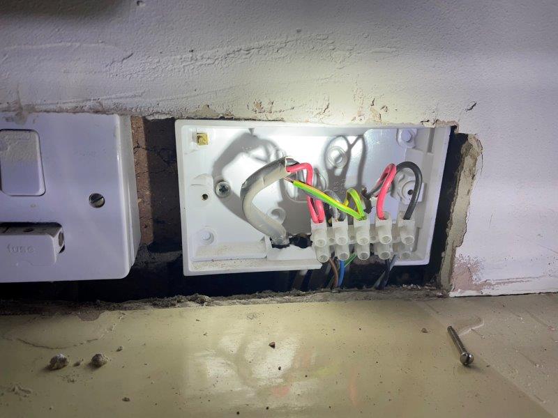

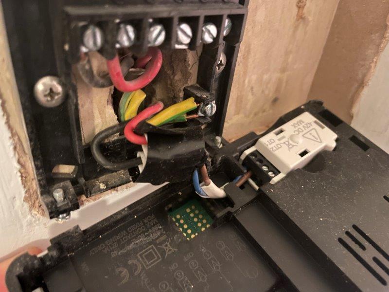

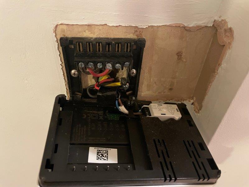

  • In order to make things simpler, I have removed all smart TRV's and only kept the room digital thermostat.
  • Old set up had a traditional dial room thermostat which has been removed and the wires spliced to send a constant signal to the programmer (Live to Live, Neutral to Neutral), picture attached.
  • The Wiser Programmer was a straight swap with the new Wiser terminal and the Opentherm wires have been connected with the wires sending a signal to the boiler.
Problem:
Once the boiler and controller are switched on the boiler constantly runs in full power without modulating and with the boiler controls being completely locked out, this is happening regardless if there is a call for heating from the programmer or not (Heating green light on/off). I can not switch off the heating via the app even by reducing the temperatures. The only way of stopping it is cutting the power to the boiler. Currently I do not want to switch on the boiler as I have no way of stopping it from running at full temperature and I am scared I will damage it as I have already forced closed it a couple of times when I realised this was happening.
take a proper look at what you have done with the old room stat,black does not mean neutral in a heating system
Hi thanks, just to make it clear I didn’t do any of these connections the Baxi engineer did. Could you maybe offer me a little more guidance on what do you mean? Is there a certain way the should be wired?
what make and model was the origional thermostat
First (easy) test is to set the Wiser controller to Relay control (in the options menu- choices are Opentherm or relay) and see what happens (ie does boiler respond to the Wiser controller).
Second test is remove the Wiser controller from the backplate, disconnect one (or both) of the Opentherm links (the flex going into the terminal block) then power up the boiler and see what happens.
The results will determine the next steps to take...
Thank you. I will do these and report back
Would be good to see how this is connected inside the boiler, but as a rule Baxi boilers don't like single channel OpenTherm controllers. They've cocked up the implementation and so even with a combi you need an OT controller capable of controlling hot water as well as heating. To compound the issue I don't think Wiser's OT works properly either...I know they've had some issues controlling system boilers
Yes I noticed that there is no way to control the hot water output. Would I be better of with a different system? What would be a suggestion for the Baxi?
Inside the boiler the Opentherm is just connected to the top two cables on the terminal
Found the issue after opening the ECU the installer had forgotten the testing loop in which was just making the boiler fire up at max all the time.
