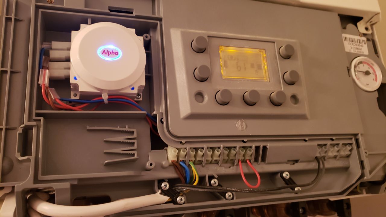

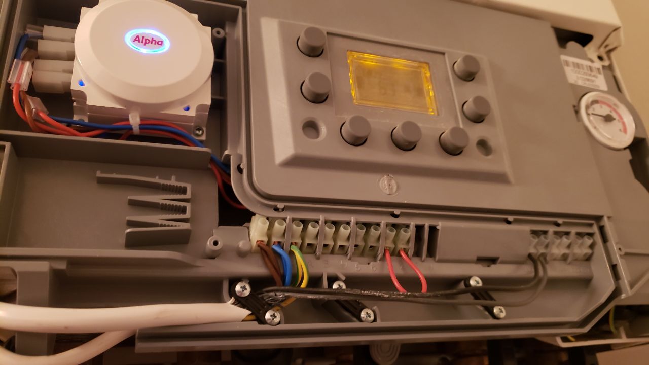

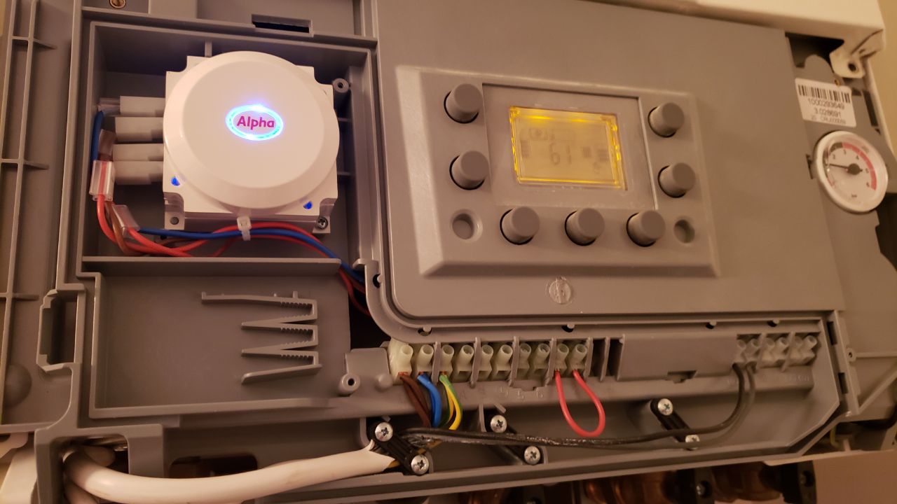

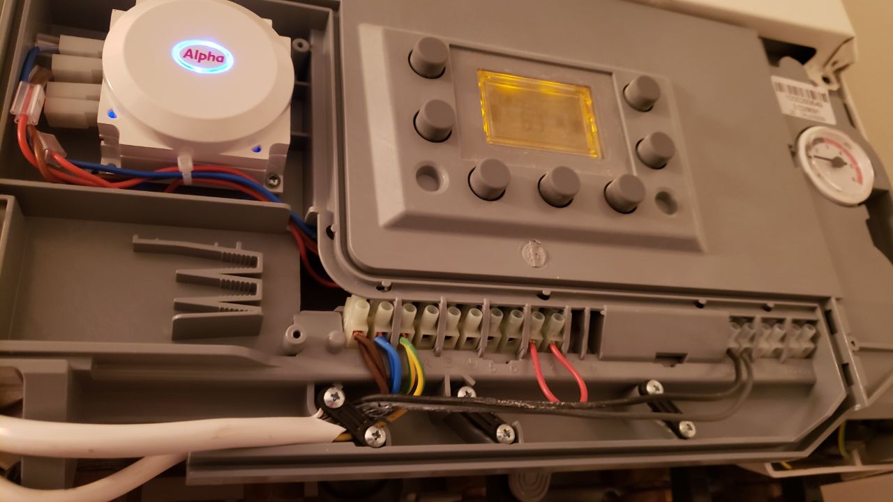

So here is my current wiring attached
1-2 linked.
3 and 4 - goes to the old alpha boiler rc
40 and 44 to wiser opentherm
I did some closer look on what is happening and at the moment I have an awkward configuration where wiser is switching the boiler setting from summer to winter instead of calling for heat.
And the old rc works as usual.
Also the boiler pcb noticed the wiser connection and now showing the sign about optional rc being connected.
There is one more thing worth mentioning regards p7 parameter. Documentation states that it may have only 0 and 1 values only, but I also have 2 as an option.
Maybe my pcb is some new revision? It did brake in December and was replaced to the new one by alpha warranty service.

Nothing jumping out at me there - but I have no experience with this boiler so I'm just checking your work against the same manual you've got.
Can you show the hub backplate wiring and the hub itself as well, for completeness?
