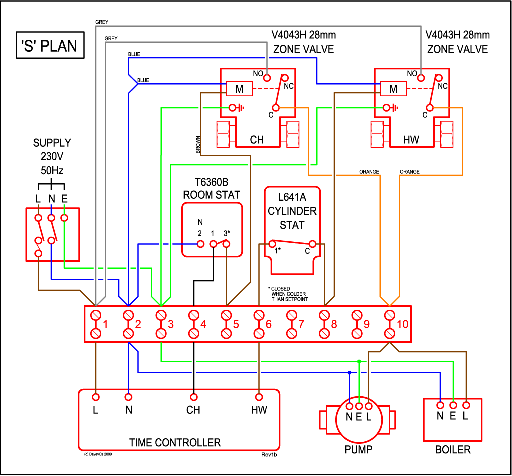

Yes, there is a permanent live going to the motorized valve(s) end switch, when the programmer and stat opens it then closes the end switch mechanically and signals the boiler to run, when you switch off or the stat switches off the signal the vlve closes, the end switch opens and the boiler then, via its own permanent live will keep the circ pump on for a few minutes after the burner is tripped off, obviously if valve faulty with end switch permanently closed then boiler will fire on/off on its own stat, the burner cuts out at SP+5C and refires at SP-5C plus the anticycle time.
If working normally, when the programmer or stat via the end switch, switches the burner off, the circ pump will continue to run (overrun) for the overrun time, then shuts down.
The schematic, below, isnt, quite correct as its the boiler logic that switches the circ pump on/off, its not switched on/off directly from the end switch.
