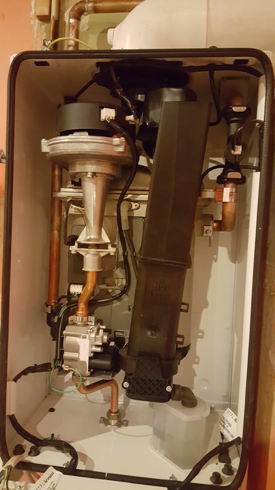

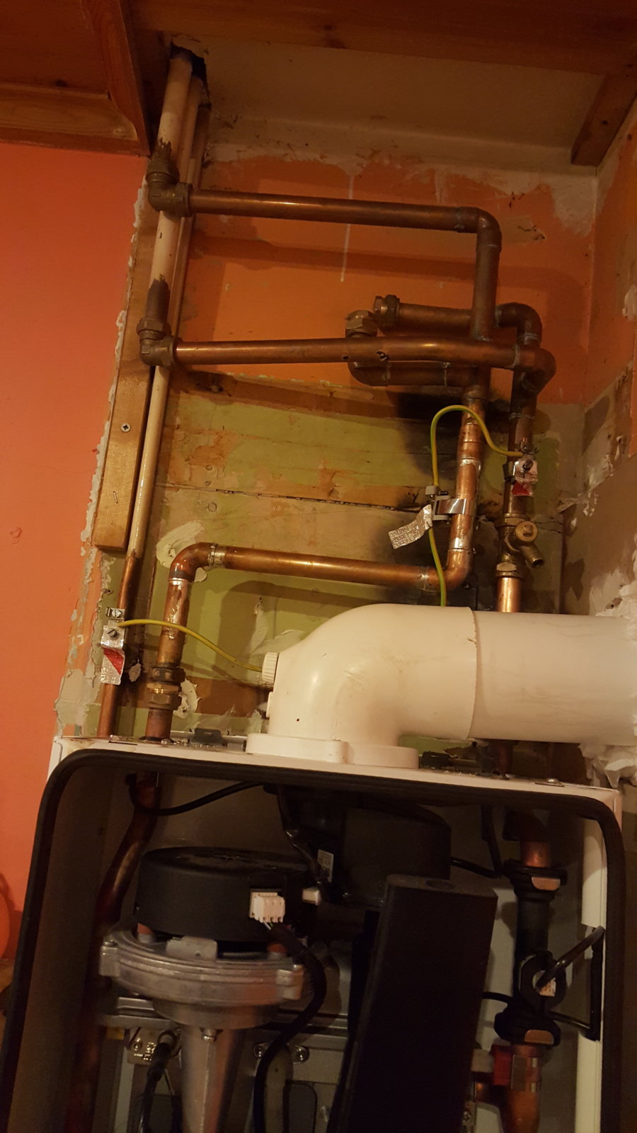

The configuration in the airing cupboard (if that's where the pump is) and the boilers connections. It is crossed somewhere.

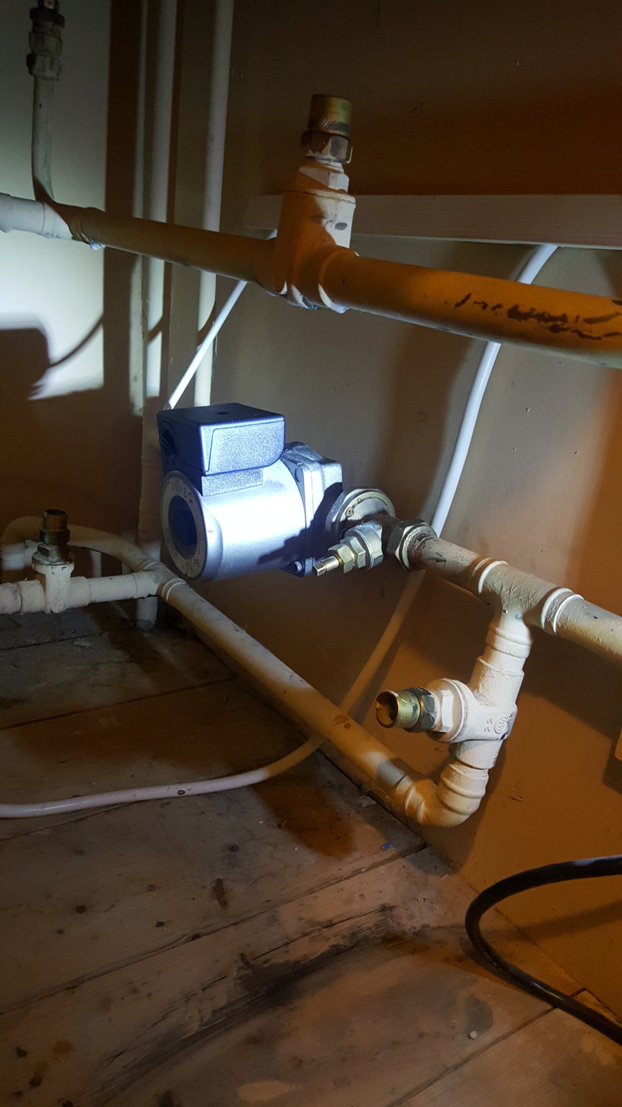

What boiler was in before? As Dan has said, take a pic of the arrow on the pump.
Ideal icos. Very similar but not so sensitive to these code things that cut it off
You're not short of balancing valves by the looks of it. Pump pic? @Dan Robinson the heating return on the left, the cyl return in the middle. OV on the right hand one? Pump must be on the return?
Just the arrow on it. Just out of curiosity, what controls do you have? The brass bits not painted are balancing valves. Its quite a mess to be honest.
