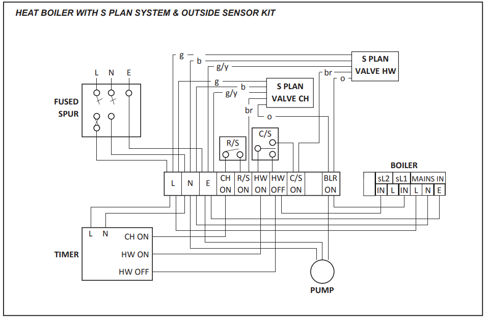

We want to stick with heat only (open vent) for our new boiler and my other half wants a boiler which every RGI will know well. Ideal Logic seems to be one of the few heat only boilers which allows PDHW natively. But I am having a problem understanding the wiring diagram:
The wiring diagram relies on using the the HW OFF terminal on the timer. But AFAIK, S-Plan does not use HW OFF. Our existing programmer certainly isn't wired that way.
As far as I can see from the diagram, when there is no timer call for DHW, the HW OFF wire sends a signal to SL2. Presumably, this signal tells the boiler that CH only is required. And the boiler will then set the flow temperature according to the weather compensation curve. If that is the case, why can't the CH motorised valve be wired directly to SL2, instead of this weird rigmarole of using the HW OFF.
I think I've worked it out now. The boiler's internal logic also has to be able to work with Y-Plan. So that is why it has to be done the way shown in the manual.
With heating only the boiler temperature is controlled by o/s sensor.
If hw is then required, boiler would not give enough heat to get the cylinder hot.
Hw on will override o/s sensor till cylinder is satisfied then hw off will hand back control to o/s sensor

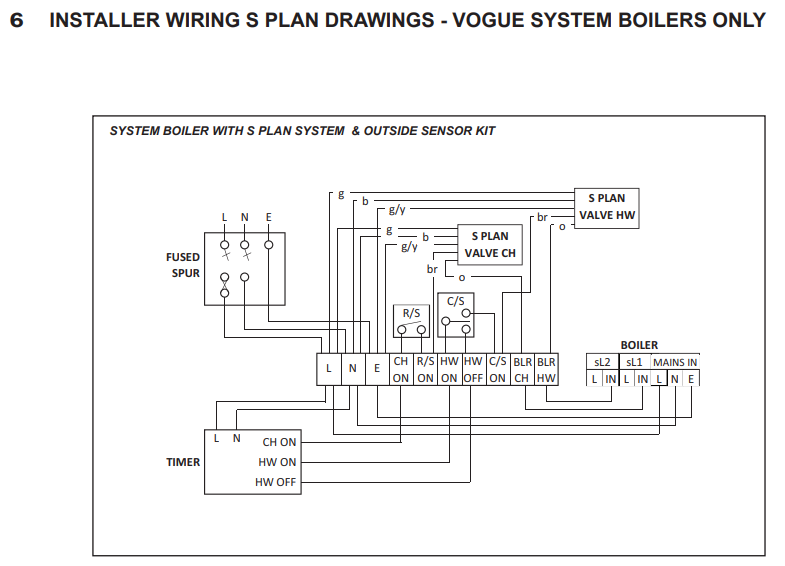

We prefer to fit the ideal vouge when going for pdhw
We go for X plan using a normal open zone valve to shut heating flow when there is a dhw demand.
With a correctly sized cylinder with high performance coil very quick dhw re heat is possible.
When wired correctly with a o/s sensor the boiler display will show what room temperature you want when heating temperature is used,heating flow temperature displayed when heating running.
I know a little bit about the Vogue set up from previous posts and sort of understood the wiring for PDHW and the X Plan. I thought the wiring for the Logic would be the same and that the Vogue's X Plan set up could also be used on the Logic. But it looks totally different. SL1 and SL2 seem to do different things on Logic and Vogue. I think Vogue only comes as a system boiler, not OV.
You can actually ignore the hw off connections, they just connect to each other and nothing else.
It is a diagram adapted from a y plan diagram.
I thought that might be the case.
I vaguely remember a fully worked up wiring diagram for PDHW on a Logic. I have a feeling it was provided by Sim the Urban Plumber on his website. But I can't find it now. I wish I had saved it!
