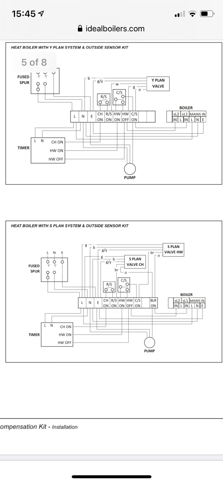

SL2 in our boiler should be wired from HW off at clock and Cylinder stat. This then allows the outside weather comp to work.
The reason being if it’s a warm day and both heat and Hw on then weather comp will run the boiler at a lower temp so rads don’t get too warm but this means cyl won’t get to temp.
Once cylinder is satisfied power is sent down SL2 and the weather Comp is then allowed to be active.

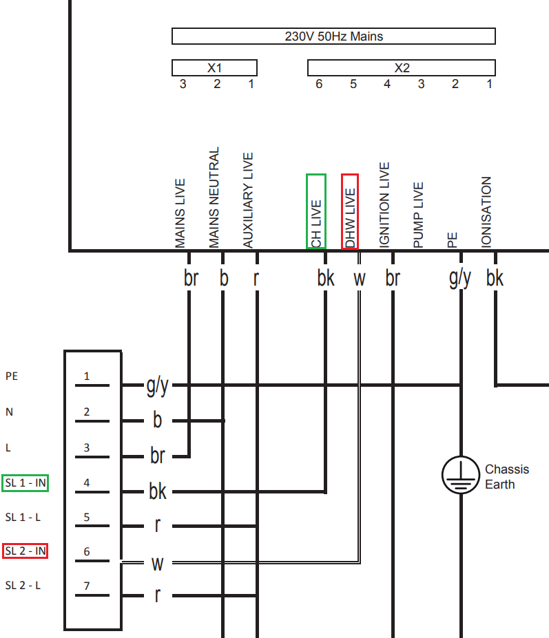

What I was looking to have was CH and HW using OpenTherm. I wired it all up and used the Nest Heat Link outputs for CH and HW to operate the vales only. The only connection to the boiler was using OpenTherm. With this setup the HW was only working when CH was on and the HW only reached the temp required for CH.
Possible solutions which need clarification are:
1. When using OpenTherm to control the boiler, the Nest should demand a higher temp from the boiler when HW is on. As far as I can tell it doesn't and HW boost doesn't work either.
2. Wire the Nest so that CH is using OpenTherm and HW uses the traditional switched live to the boiler. Ideal said they don't recommend this as the boiler might get confused.

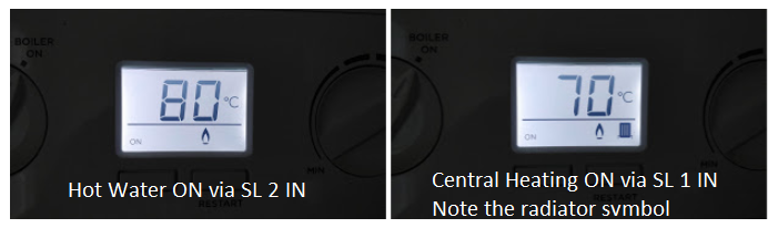

Currently I have it wired up to do traditional switched live call for heat for HW and CH. Contrary to what Ideal told me, call for CH and HW do operate differently:
1. when there is a call for heat for CH (SL 1 IN), the boiler will only heat to the temp set on the temp dial on the boiler (In my case, 70 degrees)
2. when there is a call for heat for HW (SL 2 IN), the boiler will heat to what I presume is max temp (In my case, 80 degrees)
3. if there is call for CH and HW, then the boiler runs at 80 degrees.
SL2 is for HW off not HW on. This then means the outside weather comp will work. that is the only use for SL2 as far as I’ve been told.
Don’t know what it does if weather comp not fitted. Although I do know it will bring boiler on at max temp as I’ve had one wired wrongly like that so I suppose you could use it to heat hw flow to 80deg if using end switches from HW zone valve into SL2. meabs that if heating and hw on together roads will get to 80deg.

The manual seems to imply that SL1 IN is for CH and SL2 IN is for HW (https://idealboilers.com/uploads/documents/logic-system-s-installation-and-servicing.pdf page 34)
The LCD display seems to reflect this too:

That’s internal wiring. It’s external you’ll need. I’ll get wiring instructions for use with weather comp. you then need to know if the function is different if no weather comp fitted.
The weather comp wiring takes me deeper into the rabbit hole... It's unlikely I'll ever use weather comp so your statement above puts me back to trying to understand the logic that's built into the boiler when switched live HW and OpenTherm CH are used at the same time.
