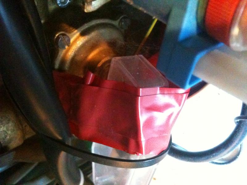

I've taken the outer casing off the boiler and can see that someone has wrapped red tape around the part of the boiler that is banging (on the left hand side). I am a bit worried in case it's some sort of 'pop off' safety valve that's being held closed. I've posted a photo in the album 'Ideal Mini'

It looks to me as if its been bodged and that may well mean dangerous, either for you or for the boiler.
Can you post a close up of the part of the boiler on the left with proper lighting.
Tony
Looking at that picture someones either lost the retaining pin from pump proving switch or broke the bottom of the micro switch housing to try and bring the mircoswitch closer to the proving pin. You really need to get someone to come and check the boiler, banging is more often than not due to temp/flow issues and possibly the reason the pump proving switch is mackled like that cause pump is running slow

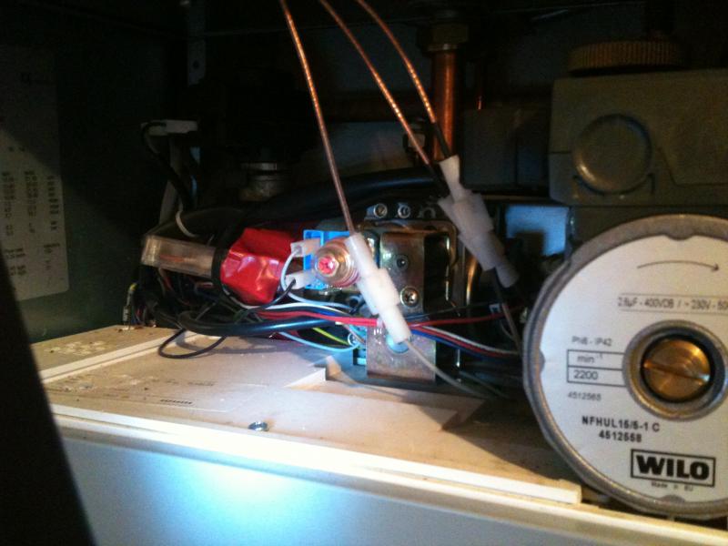

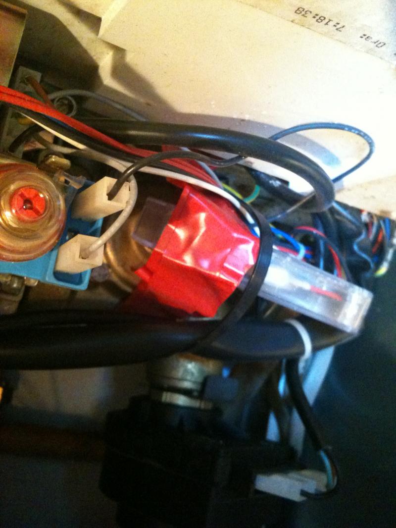

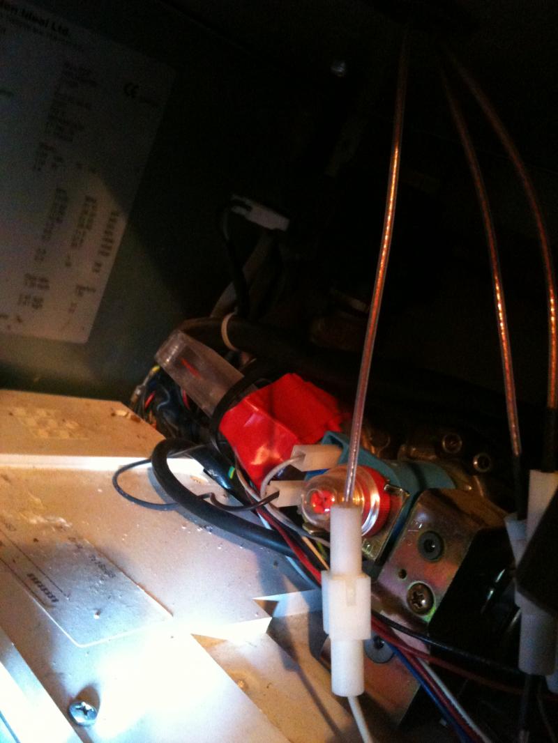

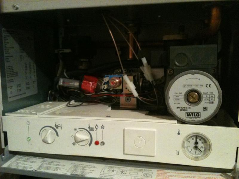

My daughter is living in the house at the moment. I've asked her to take some photos, which I'll post here as soon as I get them.
Hope these photos help: -

Would it be worth changing the main flow control valve diaphragm and switch as a starting point as it looks like it's been bodged in the past and is the part that moves around when the boiler is banging? What about changing the DHW flow control valve at the same time as a precaution?
0.7 Bar is insufficient to force water to the top of the system. It should be set to 1.5 Bar cold.
The switch needs to be fitted with the correct clip. That will probably then display the other symptoms or not work at all.
The system is probably very dirty and the boiler partially blocked.

All you seem to need is the clip!
But the switch box might be broken.
I dont recommend replacing anything unless there is a clear requirement to do it. I go to quite a few failed DIY attempts where all they have done is fit expensive parts which were not required and add faults in the process.
Its not possible to correctly diagnose boiler faults without testing and inspecting.

The boiler has an auto bleed valve behind the pump.
You can loosen the air cap and then close it until it JUST becomes tight.

Just a follow up to say that topping up the pressure and bleeding the radiators has cured the boiler banging and clanking. The DHW flow switch is still temperamental, so I may consider replacing it at some point in the future. My daughter is chuffed to bits as her house now gets warm when the central heating is on :)
