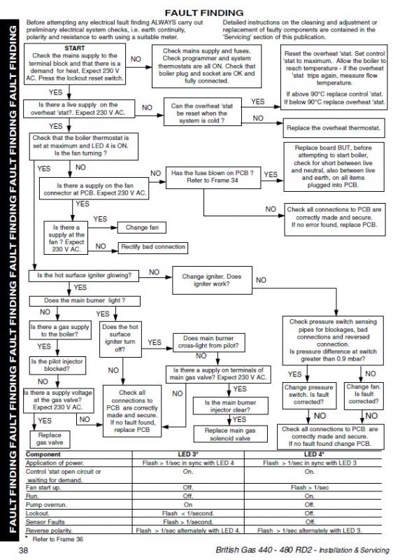

Does anyone know off hand what resistance I should 'expect' on the thermistors on this boiler?
I knew it once before (when I had to replace them), but have since forgotten :(
I know that OC or SC would be obviously faulty, but I'd like to know roughly what range I should expect to see (cold boiler).
As some background the boiler nicely comes with a diagnostic flow chart, but I think it is pretty much redundant, as I have LED3 flashing >1 per second, and the table at the bottom of the chart indicates that as "Sensor Fault".
Also, does anyone know if 'Sensor Faults' is limited to just meaning the thermistors, or would the APS also be covered by this?
Thanks!

Quick update of the readings on a cold (brrrrrr!) boiler, (sensors disconnected from the control PCB):
Grey (Flue): 142 kOhms
Blue (Return): 14.5 kOhms
Red (Flow): Open Circuit
So I know the Red / Flow thermistor is faulty, (as predicted), but but does anyone know what value it is 'supposed' to have, and also whether it is possible to substitute either the grey (or more likely) the blue from the old harness (if I can find it) in order to get the boiler up and running until I can get the replacement harness?
NOTE I don't want to do anything unsafe, but if the 'blue' and the 'red' thermistors are known to be the same then this would seem like a reasonable approach, otherwise we'll just all huddle together under some blankets until I can get a replacement delivered :)

Right have you checked the resistance of the plate ignitor? Anything more than 90 ohms boiler logic thinks its not lit and led will come on
So matey id just have a check of this before you fire a harness in.. Glow plug is a lot cheaper than a harness

Its not an approved repair, but in an emergency until the correct part can be sourced an old return NTC can be used to replace the flow NTC.
