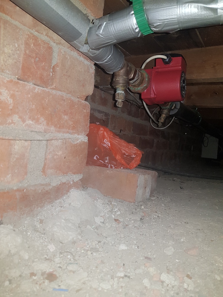

Then you have a circulation issue and the first thing to examine is the circulator ( pump) which may not be working . Show us a picture of it .
Its a Grundfos, it's on the return after the last downstairs radiator (and return from upstairs I reckon) before the boiler but just out of reach from the access for under the floor – I need to get under to reach it and it's a tight squeeze for me now as it is ! I can make it a bit larger though.

Can't you remove the floorboards that are above the pump ? Or at least reach to the large chrome screw in the centre of the pump. Removing that screw ( with electrics switched off) will allow access to the pumps shaft / spindle ,to see if it's turning freely.
Sadly no - that's under the kitchen and tiled !
It's just over an arms length (mine anyway) away...I reckon I'll have to make the access more suitable to my "frame" !

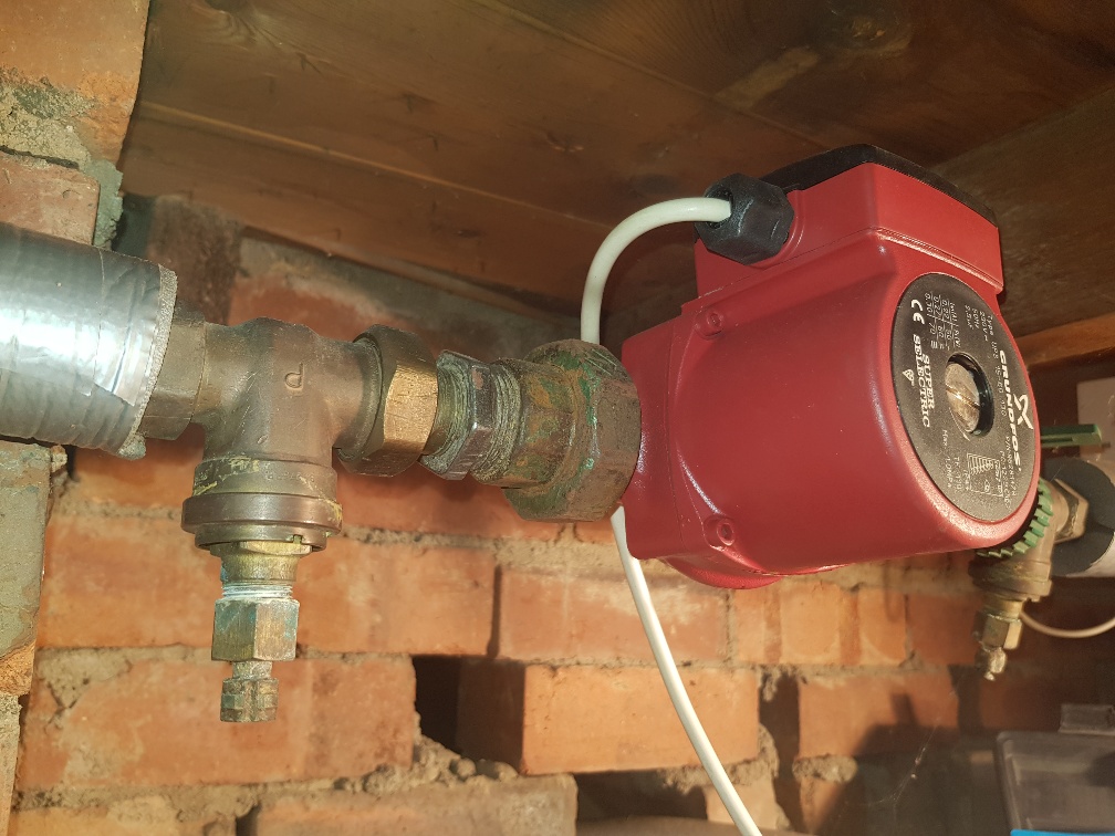

Now having access under the floor the pump (Grundfos USP 15-60 130) which looks to have been replaced in 2013 seems to be running OK.
It's fitted horizontally with the outlet side slightly higher than the inlet although it is pretty much at the lowest part of the system – pumps always been there although as far as I know.
Removed the vent plug and checked the impeller moved OK – switched back on and ran and it was spinning OK with a narrow squirt of water being thrown out.
Of the three settings it's on No 1.
Ho hum, should perhaps I'll try II although why since recently does it seems to have been working OK ?
MTIA for any further help.
