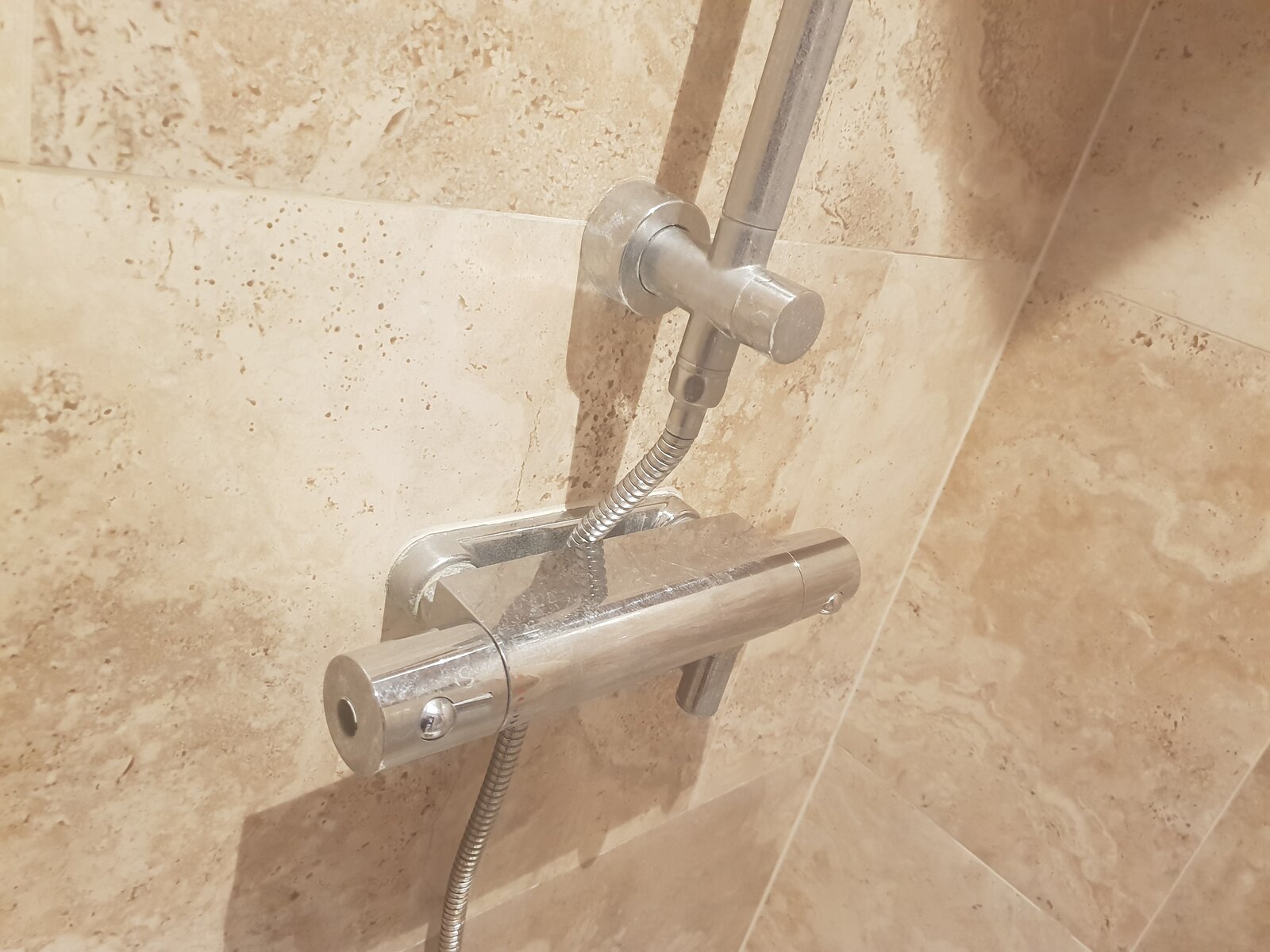

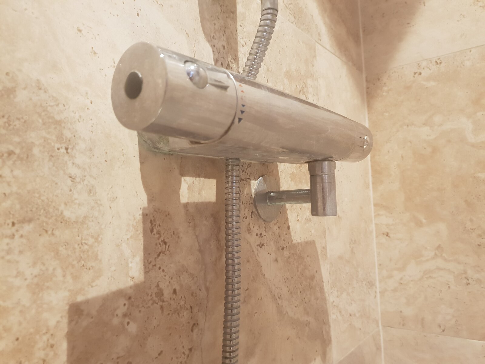

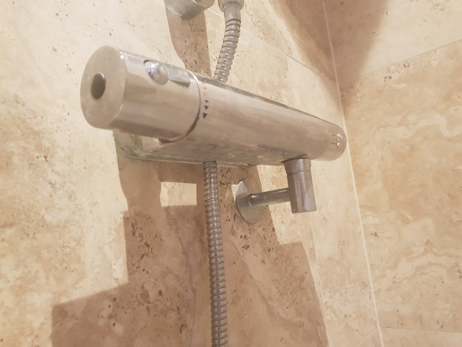

Hi, my shower has developed a drip. Reading the forums seems to suggest a faulty cartridge (agreed ?). If so, can anybody identity the make of this mixer bar?
Many thanks.

Annoyingly, it is probably just an O ring. Unfortunately, yeah is is often easier to replace the whole ceramic cartridge.
In the past plumbers on this site have provided me with links to a website that will determine your cartridge after you email them a photo.
Thanks for your reply.
Just bumping the thread in case anybody can help identify it...
Nope, not a familiar design, send a pic to https://www.showerdoc.com, that may get you an ID.
That being said, chances are it will be a generic 1/2" 1/4 turn ceramic valve and as long as the splines are standard then shoudn't be an expensive fix.
