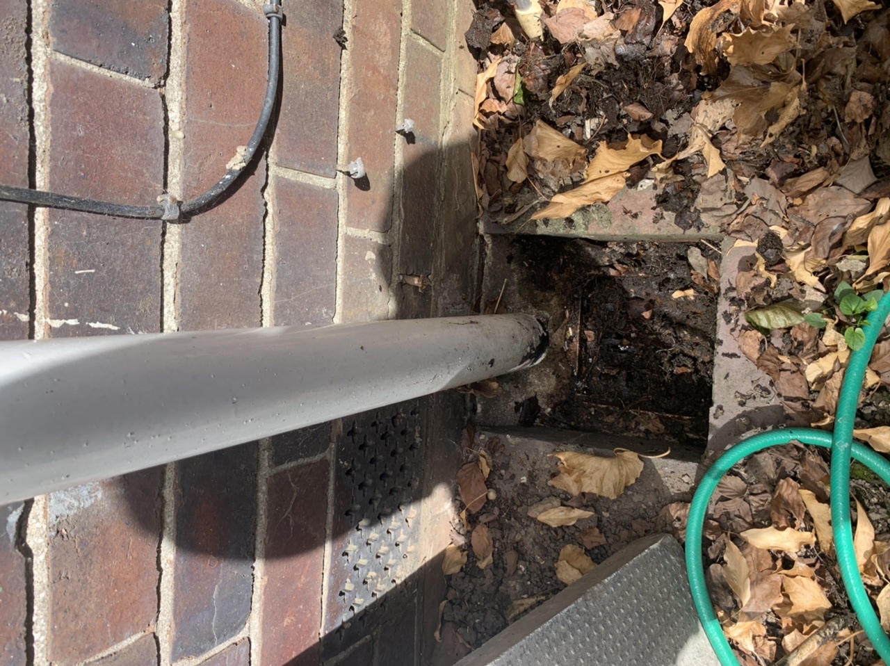

I have a drain at the side of my hose that I want to know if it’s connected to sewer or soak away. Is there a way to check this?

Dye test would be a good start, put dye in a bucket of water and tip it down the drain, observe if it arrives at a downstream manhole.
Also depends what else your planning to discharge into it, a rainwater drain may connect to a surface water drainage system, so you wont be able to discharge waste water into it.
Photos pls.
This is the drain in question. I’m sure we only have combined drainage here. 1 inspection chamber which is on the other side of the house to this
The pipe in question is further forwards towards main sewer then manhole so can’t try dye test unless I had a camera down it at the same time
If you launch a bucket of water down you should hear it from the manhole.
Then, if it does join the sewer system, there "should" be a manhole at that junction.
Unless it’s been covered by previous owners, I only can see 1 manhole on our land. Our last house didn’t have any
