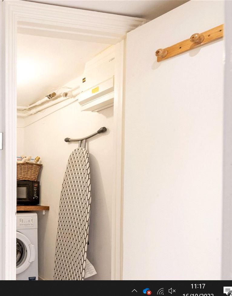

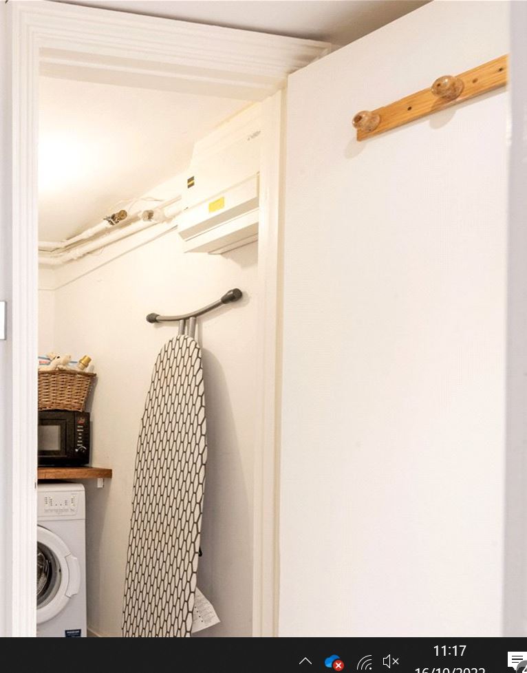

Please can anyone help me to identify the piece of kit in the photo - next door has attached to our party wall - and it's noisy - but I've not idea what it is. Thanks a lot. G
Noise will not be coming from the consumer unit, nor from the hatpegs or the ironing board.
Noise might be coming from the pipes, and is very likely to come from the washing machine.

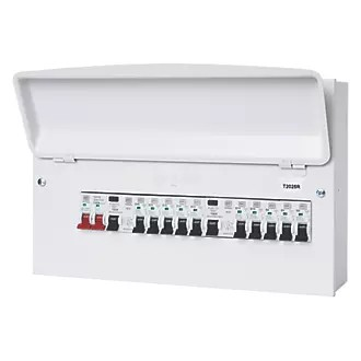

Here are some examples of consumer units to help you recognise them. Old people call them fuseboxes

Thanks for your help. It's something that can be switched off and on - unfortunately for me the optimum time for neighbour is 1130 pm and it then judders all night through my place - it's not a washing machine which would only run for an hour or so. Thanks though. G

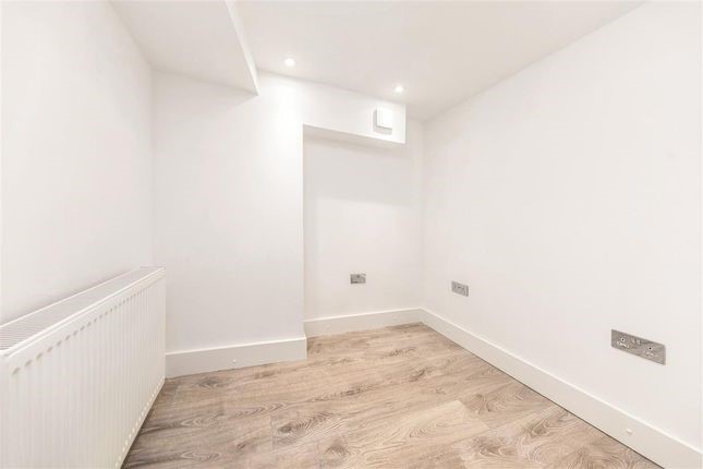

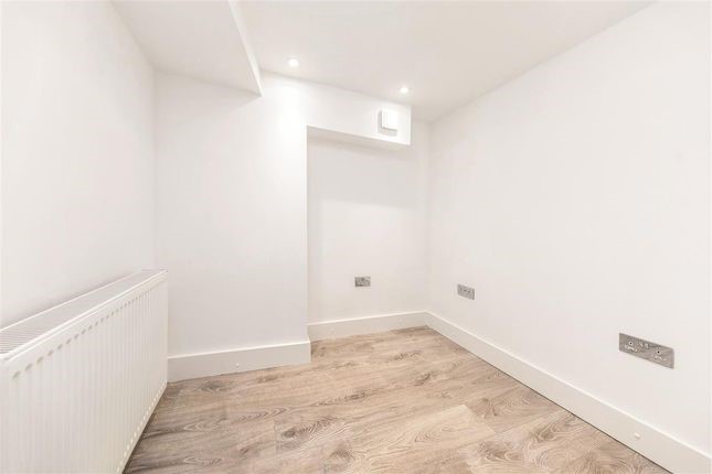

The boiler is not on the shared wall - overflow is out front - it's not dripping. Noise is a loud hum it goes up and down with intense bursts, sounds like a motor - vibrates all through my place. The room you see is under my flat - but when first cranks up it is very loud on our shared wall other side is their kitchen - that dies down a bit but the rumble goes on. There is a pipe on the flat roof of neighbours flat - some kind of tall vent - perhaps it's air filtration - something like that? She recently refurbished but won't say what it is - believe me I've asked. Thanks so much.
Could it be an air source heat pump?
Does the neighbour use a gas boiler?
Modern tumble dryers with heat pump also run for very long periods. You will hear the washing machine spinning earlier.
Yes there is a gas boiler it's not on my wall. I don't know what is a heat pump? Tumble dryer - I don't know - would that run all night? These vent covers are dotted around her place. Please note I only have this info because recently put it on market for renting out. I haven't broken in :)
