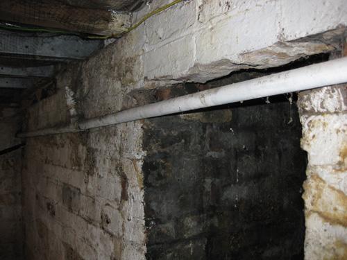

I am about to have some work done in my cellar and we are trying to figure out what this pipe is. It runs along the front of our cellar (terraced houses) and presumably goes into each neighbours property. Although, they cannot confirm.
We are thinking its an old gas pipe? Can anyone confirm?
Here it is running along the wall and across the coal chute...
And this is about half way across the wall...
Here is our gas meter, which has a gas main coming in from the street. The unknown white pipe is not connected to the meter at all....

Definately gas, it's an old meter position. Don't think you can touch it as A) it doesn't belong to you B) probably still live, if it is you have no way to isolate it and could land you in deep sh!t if it leaks :eek:

So how do we check if it is live or not? Can the gas people come and look and will they be able to cut it/re route it?
Its only about 2 inches in the way, but a fairly improtant 2 inches :)
Definately a gas pipe with old meter point and a capped off ECV. I would guess that it is probably not live, as it looks like you have had a new supply installed to your meter.However just to be certain you will have to contact the local gas transporter to check it

If you thought you could smell gas in the cellar, you could ring the (gas transporter - in my day Transco) emergency No on the front of the Meter. They would attend within 2 hours and check for gas leaks at all obvious sources. Which would mean also checking the pipe in question. This is a free service. However if they did find a leak which was upstream to the meter they would cap the gas supply. You would then need to employ the services of a RGI to find the leak, make repairs, and reinstate the gas supply

Just in case any one is intereted. National Grid have arranged for an engineer to come and look for us - it ony took a quick email to ask. Nice and easy.
