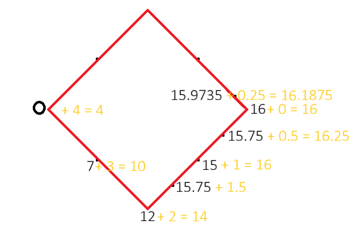

Thinking about it, the obvious thing is to limit Zs.

FWIW applying the 1/8 from the centre point rule: In order to make calculations easy I've assumed a ring resistance of 64 32Ω and zero source resistance- yes I know unrealistic but can easily be scaled to any real value, the following sketch shows the ring L+N resistance and end of spur L+N resistance at various points
The 1/8 rule prettymuch limits the end of spur resistance to the maximum of the ring
Yes, on reflection, as you and Sunray have said, Zs is fairly obviously what it was about.
However, one cannot say anything about the maximum permissible length of a spur from a ring (Zs-wise) without knowing, or making some assumption about, the Zs of the ring itself (highest at mid-point of ring).
It seems that, at least for some purposes, they have assumed that Zs at the mid-point of the ring was already the 'maximum permitted' - in the sense that that explains why the stated 'rule of thumb' does not allow a spur of any length at the midpoint of the ring (and makes permissible spur lengths impractically short near to that midpoint).
However, what I still don't get where their "one-eighth" comes from. I haven't got time at the moment to do the proper sums, but will later. However, for starters, assuming that the mid-point of ring is already at 'maximum Zs', it would seem that a spur originating very close to (or even 'at') the origin of the ring (in same size cable as ring) could have a length equal to one-half (not one-eighth) of the distance from that point to midpoint of ring and still have a 'just OK' Zs, couldn't it?
More later, when I have a little time to look in more detail at the numbers.
Furthermore, and more to the general point, if it were a small ring, with a Zs at midpoint well below the 'maximum Zs', it would be possible (Zs-wise) to have a much longer spur than the rule-of-thumb indicates - ultimately potentially longer than (let alone 'one eighth of') the distance from spur to midpoint of ring!
