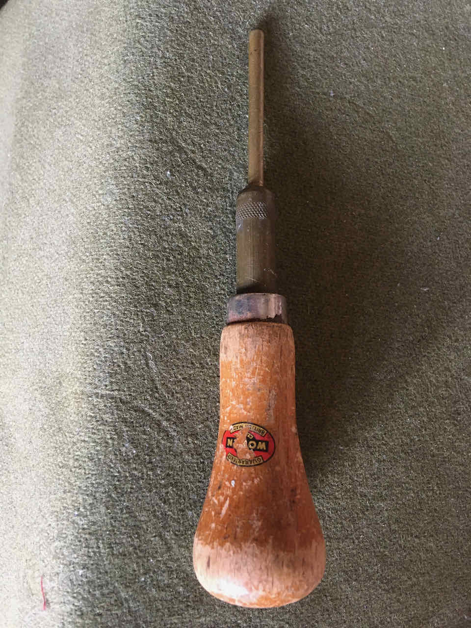

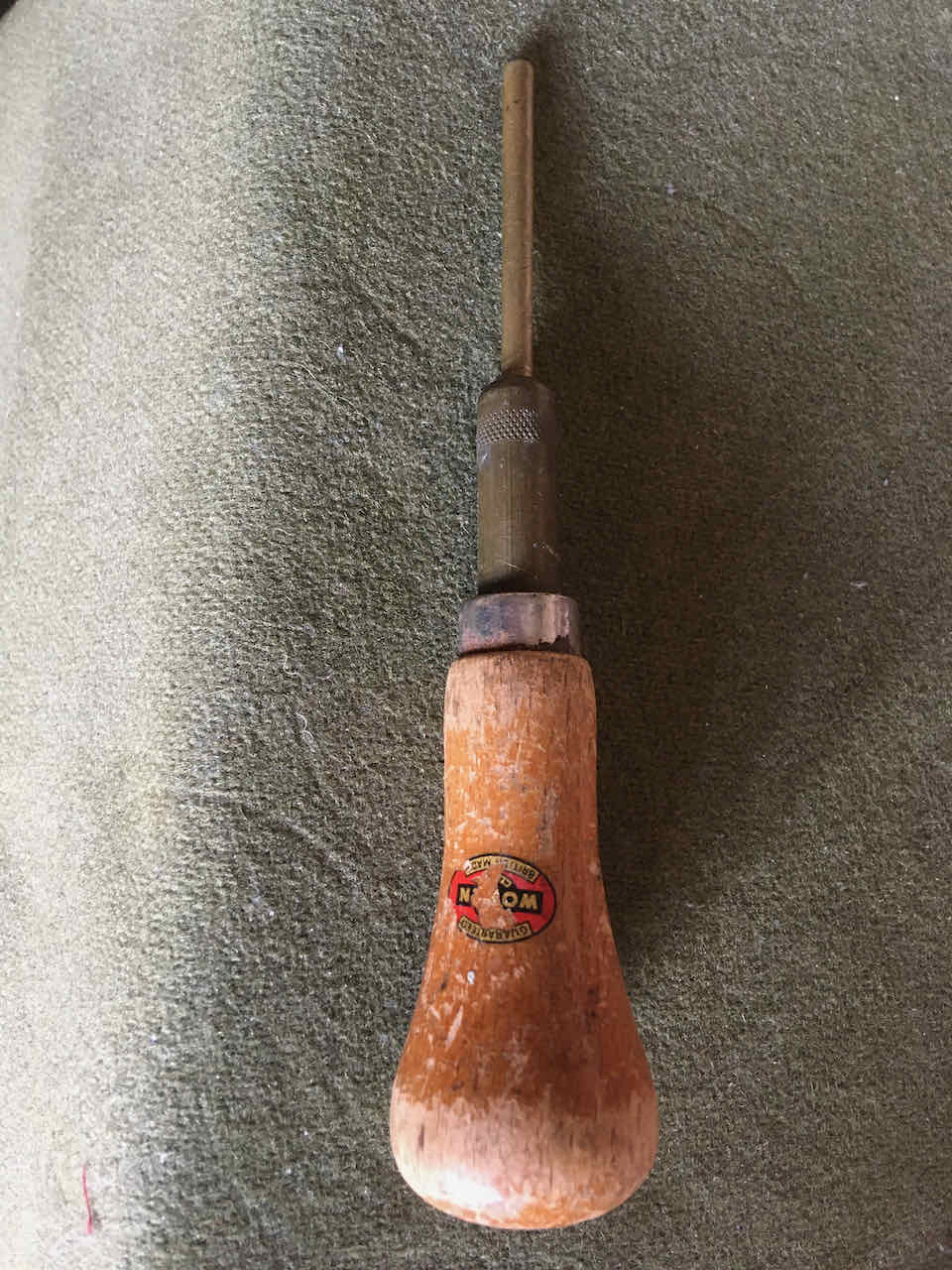

For anyone unfamiliar with them, this:
is a rampin. It's basically a tube with a spring returned sliding drive pin inside it that has a knob on the end of it. You pop panel pin into the tube where it is (sometimes) held by a magnet, position the pin where you want to drive it in push down on the top of the knob to drive the pin in and the spring returns the drive pin to the start position. If it doesn't quite sink the pin you can always finish off with a hammer and appropriate size nail set. May sound slow, but in the days before 2nd fix nail guns it was faster than setting dozens of pins by hand not to mention greatly reducing the chances of mashing a finger or thumb with a hammer. At one time there mist have been half a dozen firms making them

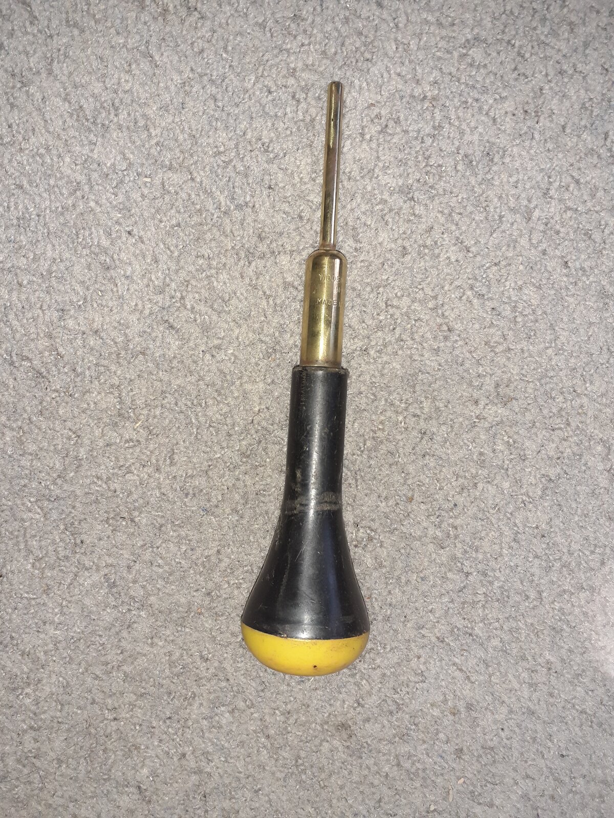

heres mine, but it is broke, the Pins , even long ones at around 2" dont come out - whatever holds them in at the back has gone - so i push all the way and the pin is still inside.
I seem to remember a bit of a kick as you pushed down as well, I did a lot of small 2ft high T&G around a lean too - i think in the 90's with it
Anyway - seen a spear & jackson one on amazon looks OK so may get that , next time i order

Just PM me an address and I'll pop that one I pictured in a jiffy bag to you. It's going spare as it came to me as part of a job lot of tools in any case - and I can only use so many rampins
