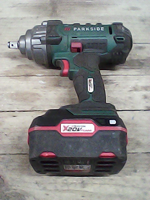

Parkside brand from Lidl.
Got it earlier this year and has been fine and dandy. Started using it today and squeezing the trigger, its start/stop in both direction although if I slide the forward/reverse back and forth a bit, I can get a bit of spin.
Battery has a full charge.
Anyone had this bother with this brand?

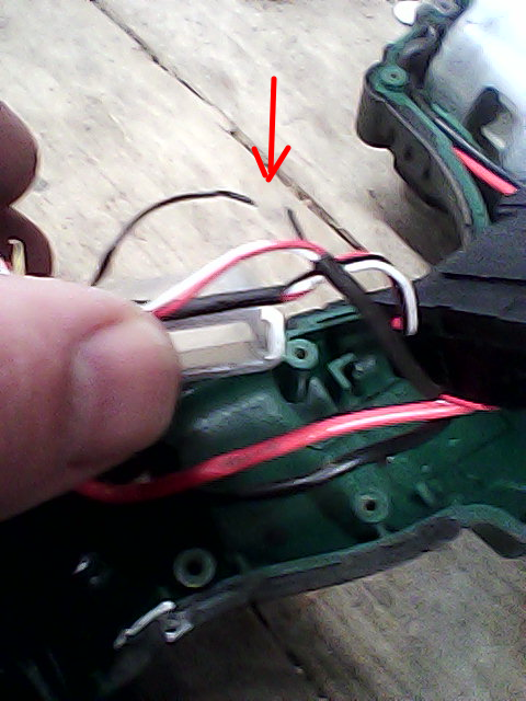

Fixed!
A broken wire (nipped) on a multiplug that plugs to the torque control pcb.
