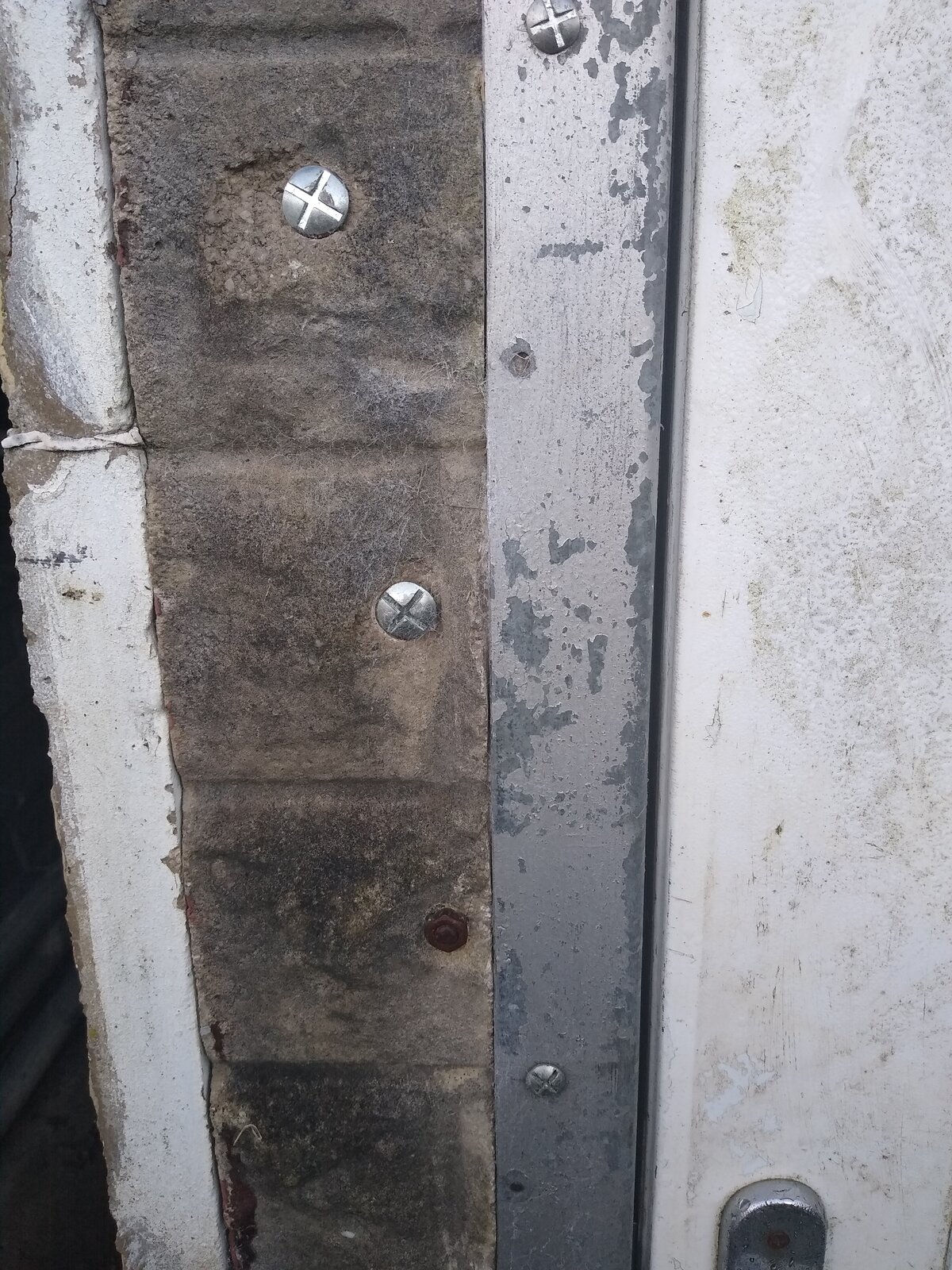

I've just been speaking to my father in law (joiner) and he's said that he's sure he remembers being told never to drill through pre cast concrete garage panels like we would have to to attach a frame because apparently they're liable to crack badly which would affect the strength of the building as a whole. Anyone know if this is correct? We had been discussing screwing some timber battens across the outside and cladding it. The battens would obviously have given the building the 8ft height i was seeking.
If you drill a new one it invalidates the warranty , the Panels have steel re-inforcing rods in them , there’s usually holes you can bolt through

P.S. here's some holes I drilled earlier - as you can see there is a risk that a bit of the finish may break off but mine are old and ropey and will be covered eventually.
