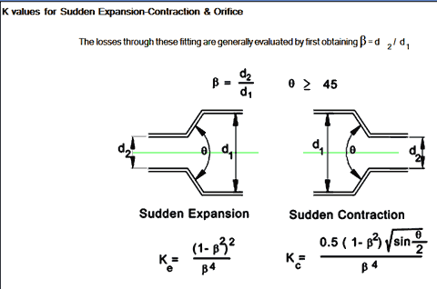

This is dependent on the flow rate, at greater flow rate you get more loss. the loss is proportional to the flow rate squared.
The loss is usually given by
Loss Factor x 1/2 x Density (998) x Velocity (m/s)^2
This has the units of Pascals, Rearranging that and you get
a head loss
h = Loss Factor x 1/2 x Velocity^2/2gravity (9.81)

You never answered my final point on that thread about velocity and the wide variations between the two sets of tables. :(
Sanj you seem to be saying that dear old Darcy Wiesbach (sp?) is wrong, or has forgotten about something.
head loss due to friction, head loss due to height gain. What else?
I don't believe there's a lot that new in the world of fluid mechanics, so perhaps you could refer to an equation which accounts for the additional "upwards friction loss" you're referring to?
