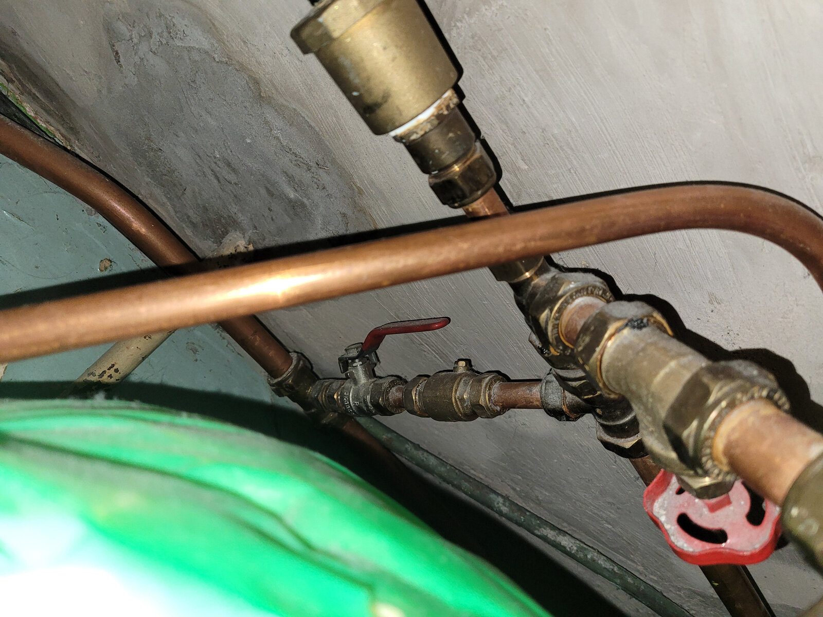

So the airing cupboard presents probably a standard picture. A copper pipe from the attic water tank connects to the bottom of the cylinder. Hot water for hot water taps comes from a copper pipe at the top of the cylinder. To heat the cylinder a CH flow pipe from the boiler enters the cylinder in the bottom 1/4 and emerges (CH return) from the cylinder in the top 1/4 and goes back to the boiler. On "top" of this return circuit there is a Valmat 10bar automatic air vent.
So far - I get it.
But the next bit is "strange" (see attached picture). About 1/3 down the CH-return pipe from the cylinder in the airing cupboard this pipe is joined ("T" piece) by a horizontal pipe taken from the same pipe that fills the cylinder for the hot water to be heated. i.e. the downward pipe from the water tank in the attic(!)
This connecting pipe has a red "stop cock lever" which appears to be open. And just before the connection to the CH-return pipe it has a check valve. This valve ensures water can only go from the attic water tank into the CH-return pipe.
This has me a little bit confused. Has anyone else seen something like this.
Does it mean the system is pressurised from the attic or is just some kind of "automatic" pressure back-up system to prevent complete pressure loss and I still have to pressurise the system (loop water from the boiler) somehow elsewhere.
"Make-up water" - the manual talks about this on page 11. "Provision must be made for replacing water loss from the system"
It talks about:
My questions:
Is the arrangement I have (with the pipe from the attic connected by a one way valve) in fact this "make up vessel". i.e. I do not need to do any kind of pressurising/re-pressurising after bleeding rads. etc. (i.e. I can "ignore" the pressure gauge!)
Drayton Wiser says its system does not work with gravity fed systems. I assume my system is not gravity fed in the way they mean - but conventional.
Thanks for any insights to my system

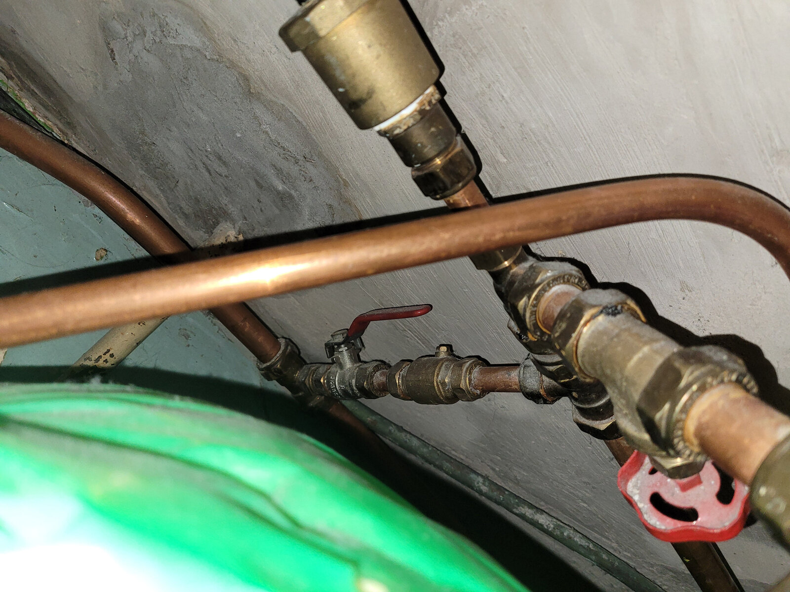

It talks about:
- a "manual" make-up vessel... non-return valve
- where a make-up vessel is difficult by "pre-pressurising" the system.
My questions:
