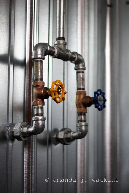

Mrs wants an industrial style shower. I'm concerned that the attached pic setup will be difficult to balance hit and cold with the inputs directly opposite each other...or am I over thinking it?
Also would prefer to use compression joints with 15mm galvanized steel for exposed pipework. Any tips for this?
As long as the supplies are equal pressure/flow then no issue although most showers are fitted with NRVs
Most barrel pipework is threaded pipe and fittings - you just need a threading machine and a bit of practise and Bob's your uncle!
http://www.gfps.com/appgate/ecat/common_flow/10005L/UK/en/109697/497242/index.html
You can build your own type of shower but it has to suit uk regulations including wras and the tmv scheme. Its about prevention of water contamination and prevention of scalding.
Maybe an always on suitable mixing/temperature valve supplying mixed water before the industrial arrangement with a single gate valve to turn the shower water on/off.
