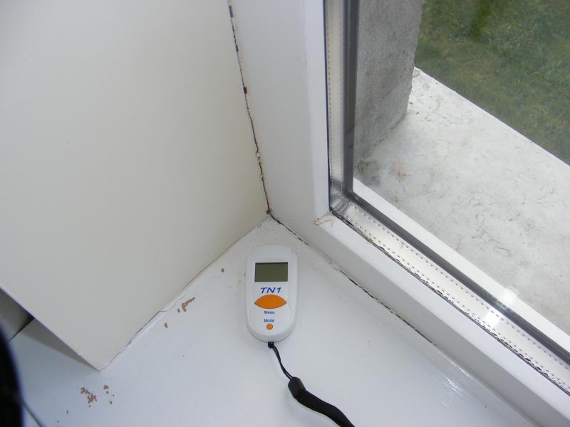

I went around measuring the room with my cheapo digital laser thermometer, the room is significantly colder than the rest of the house. The cold bedroom is about 14-15 degrees, the rest of the house is 17-21 degrees.
I think the window isn't sealed/installed properly, have a look at the photos below, the crack in the corner of the window dips as low as 8 degrees and I think I can feel a breeze there? Can I seal this somehow? From the inside/outside?

You'll always feel a movement of air if you put your hand near to a window. It's just the warm air inside coming into contact with the cold glass and convecting.
Well it's usually that, windows should be installed tightly, with expanding foam filling any gaps.
Is the window in the baby's room proportionally larger than those in the rest of the house - i.e. glass/floor area?

No it isn't, its the smallest room is the house actually. I held some candles up to the window to see if I could detect a breeze but the results where inconclusive. I have spent some time trying to locate a cold spot with my digital thermometer but that was also inconclusive :(
Hope to get a glazier to have a look at the Window.
