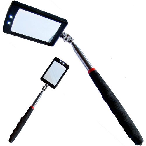

I am after one of these and unsure on what they are called and what i should be searching for. Any suggestions or recommendations on one please?
I want to be able to check behind and underneath fittings to make sure that they have been soldered correctly.
Secondly, any recommendations on a soldering mat as my current one from toolstation is in tatters.
Tanks in advance.
Telescopic inspection mirror :sneaky:

I have had a mirror like Madrab shows in the bag for years (keep it in an old slide in glasses case) would not be without it.
Also bought a sexy one from amazon with a light in it don't know how long it will last but it works well.mirror.jpg
