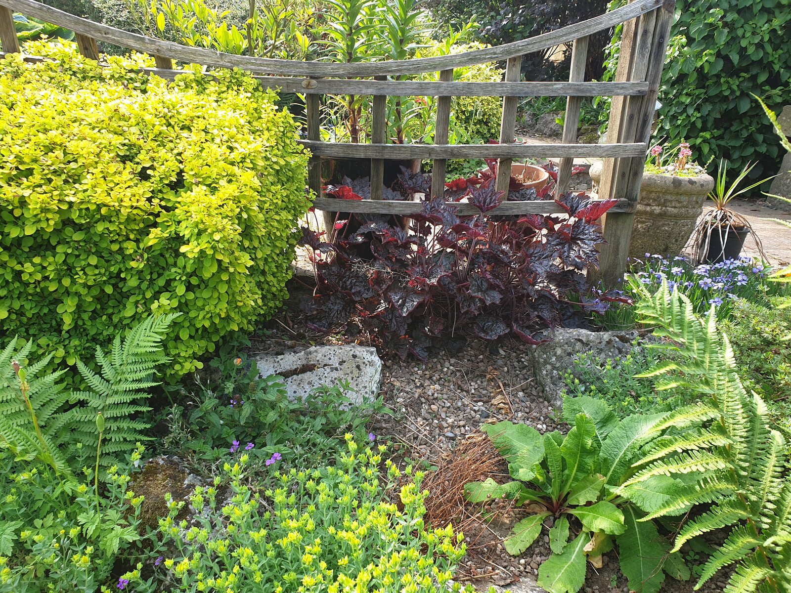

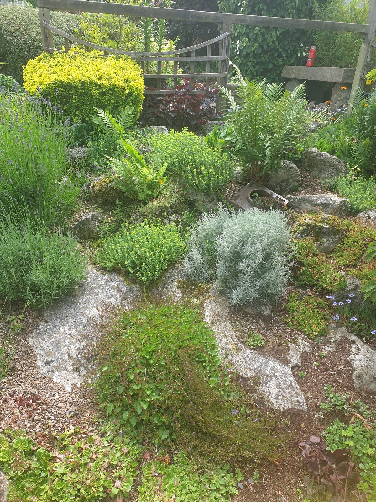

Hi there,
I've found a 175 cm childrens slide which would be normally fixed to a wooden climbing frame or play house.
I'd like to fix this to the top of a slope in my garden, but I'm not sure if this is possible.
I'm wondering whether there would be a way to fix wood to the ground and then fix the slide to this wood.
Does anyone have any suggestions for this?
Thank you.
Katie
This is the slope.

That doesn't look like a very suitable position for a childs slide to be honest, not with all that rockery and plants around it.
I think you would be much safer finding a clear area of lawn and making a framework to attach the slide to. I would suggest 2 long based triangle frames with a sturdy upright from the apex to a point directly below the apex, (so you basically see a triangle with a piece down the centre). These two triangles are joined with cross struts the same width as the slide. The slide is then attached to one side of the triangle frame and a set of steps constructed on the other half of the frame to allow the children to climb to the top. To prevent toppling sideways you can put a long piece of wood across the bottom of the slide and a similar one at the bottom of the climbing side.

You could possibly run two parallel wooden rails down the rockery and somehow secure them to the ground using wooden stakes.
Depends what your/your husbands diy skills are and what type of tools you have. I put a stop block at the end of a gravel pathway by drilling 2 holes in a length of 2" x 2" and then hammering 2 lengths of wooden curtain road through the holes and into the ground for about 18"
So, imagine you can get 2 lengths of timber to run down through the rockery pretty parallel and at the width to suit the slide. By getting some wooden curtain poles you could drill holes through the timber at strategic points, (i.e. where it will miss the rocks), and hammer the poles through the holes into the ground below. They would need to go in about 18" to be fairly secure. The holes in the runners need to be the same diameter of the curtain poles to prevent the frame moving around.
Treated timber stakes driven into the ground (18" or so, as mentioned above) should be adequate without using concrete. They should survive the few years the slide will be in use before the kids outgrow it or lose interest in it.
