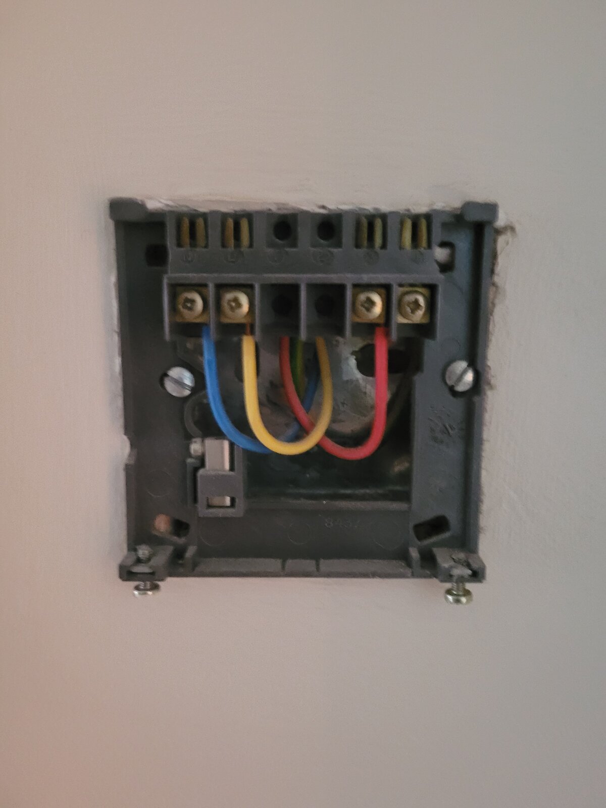

Hi
I am trying to do the reverse.
I am replacing a RET230 with an RMT230
As far as I can tell the wiring to my RET230 is:
N = Blue
L = Yellow
On = Red (terminal 3)
Terminals 1,2 & 4 are unused.

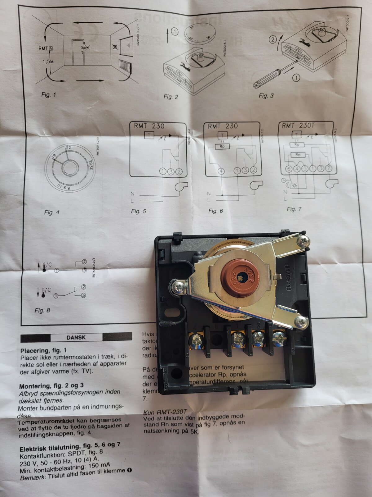

From what I can see, the RMT:
L= Terminal 1
Where do the N & the Red wire go?
I am guessing N goes to terminal 2, but Red I have no idea

N to 4
Other 2 wires to 1&2 doesnt matter which way round, DO NOT put N in 2
I'm not sure if I've understood your question, because the diagram you posted answers what I think you are asking.
L goes to 1
N goes to 4
So:
RET N = RMT 4 (Neutral)
RET L = RMT 1 (Live)
RET 3 = RMT 2 (Switched Live or ON)
Note: terminals 1, 2 and 3 will all become live at times. Do not connect a neutral to any of them. N is 4 which is why it is well away from the other live terminals.
