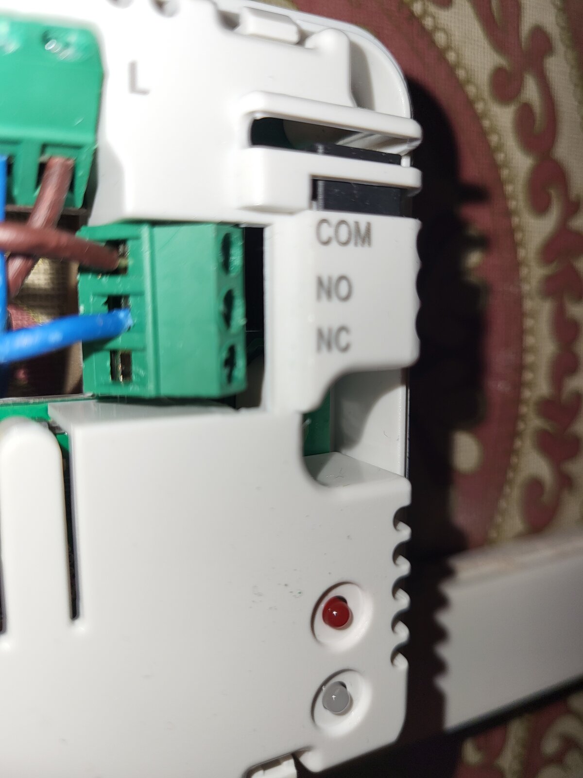

Hi all I have just had a electrician to fit a new wifi thermostat but we can't seen to get the control box to communicate to the boiler
The boiler is a glow worm -BETACOM 3 30C
This is the wifi thermostat

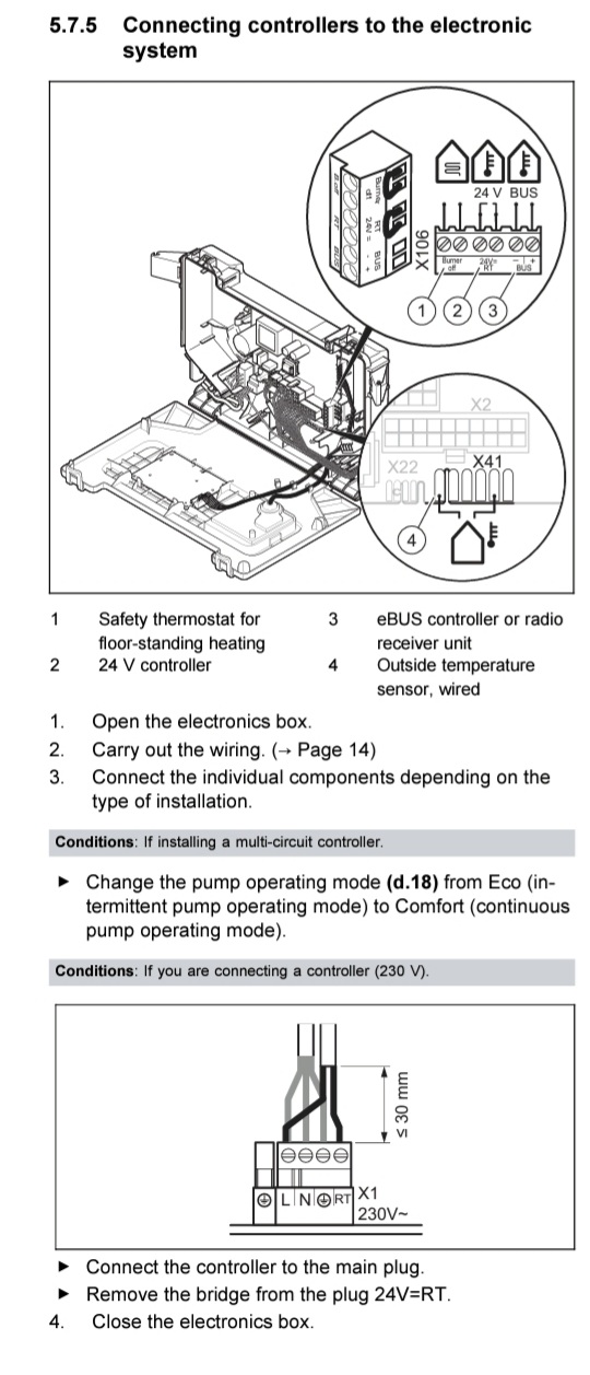

If so, the thermostat may have been 24V switching, or 230V mains switching. It would not be good if they were mixed up!
The wiring on the boiler is straightforward and troubleshooting a dodgy receiver should also be straightforward - perhaps you need a new electrician! ;)

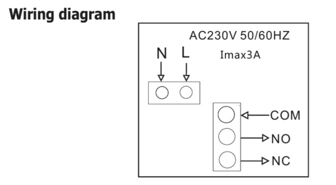

Found a manual for the 'Heating Thermostat'
Manual attached...

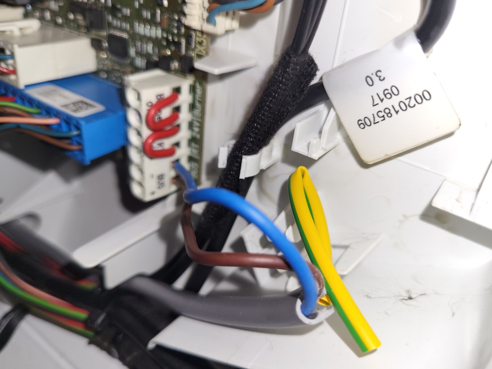

Hi it is a new install as when the new boiler was installed he didn't connect the old one up the electrician has gone as he couldn't get it working
The control box
And that is connected to the Ebus

So the 2 wires from con & No go into the 24v switching not the ebus ?
that is your problem remove the red link in 24v switching and put the wires in there not the ebus
Yes, the connections from "Com" - common and "NO" - Normally Open, connect to the 24V/RT connections on the boiler.
The ebus connection is there for thermostats that 'talk' to the boiler through a serial data link, not just the on and off switching, that your new receiver uses.
