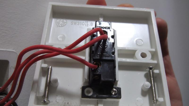

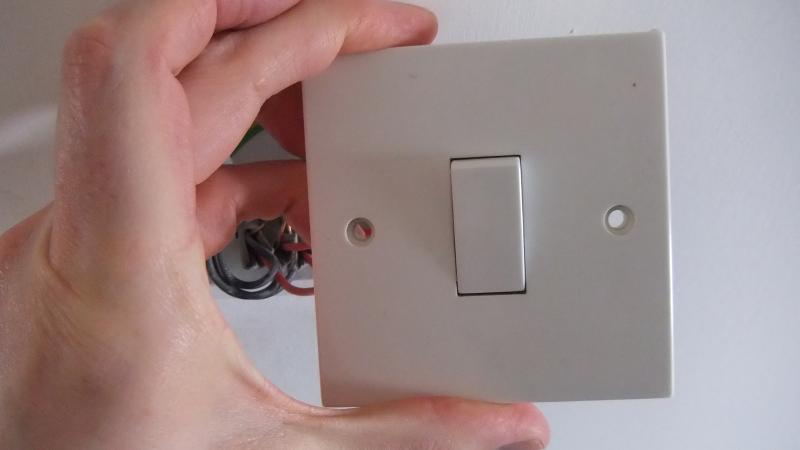

I currently have this installed:
with this wiring:

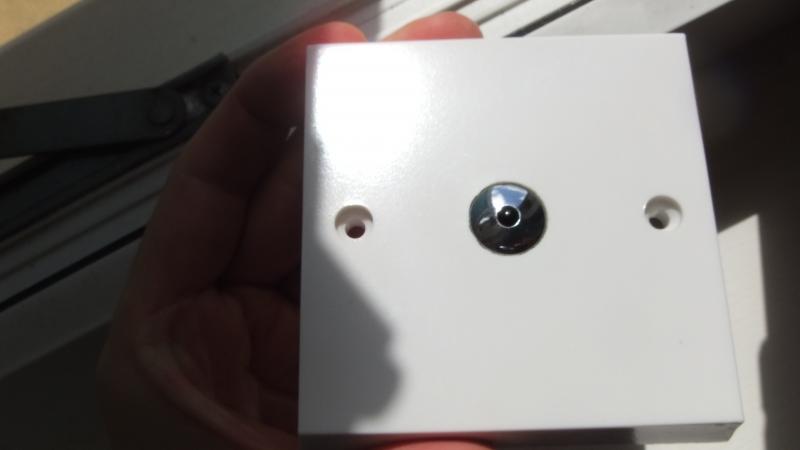

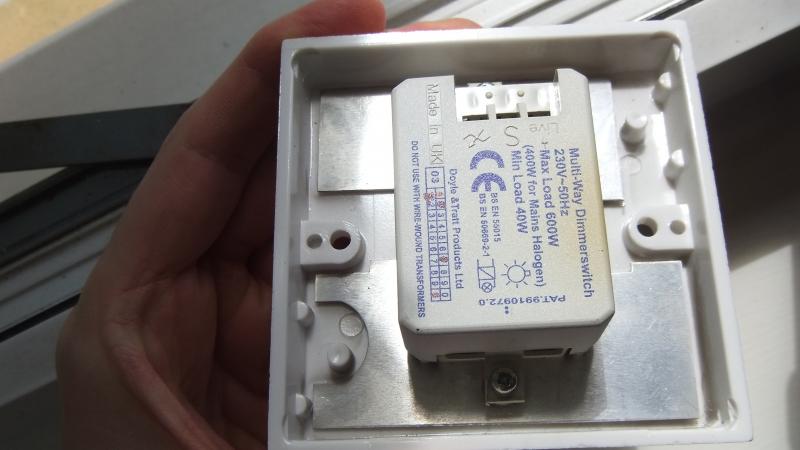

Would like to install this dimmer switch light:
with these sockets for wiring:
Can someone help me please? I am confused as to connect what to what.
The two reds at the top (in the COM terminal) go into the LIVE o n the dimmer.
The red on its own goes into the wavy live/arrow terminal.
Thats it
Just to confirm your telling me not to connect the live wiring to the live terminal on the dimmer?
