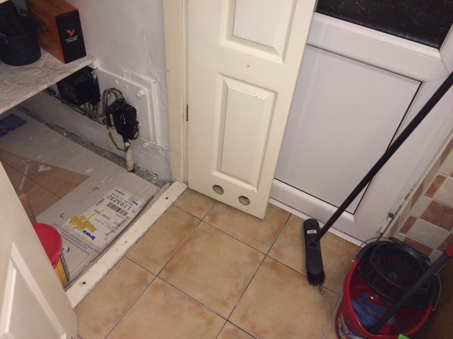

I took a video to show where our mains electric box thing is (where you can switch off all the electrics in the house). Actually in the video i only show the meter, but the switches are at the back of this cupboard anyway.
Then i'm thinking of having the socket on the side that you see in the video. I don't know whether near or far side of the black down pipe yet but basically in this area.

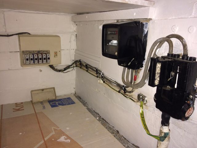

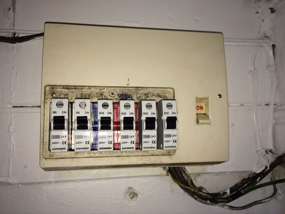

Anyway the photos asked for...

That last one is obviously showing the box in relation to the door in the video & how close (or not) things are.
Is this bad or is it just old standards? Everything else seems to have been dated in the house so wouldn't surprise me with that.
What is RCD protection anyway & is it much upheaval to put it in place?
RCDs protect between an imbalance between live and neutral. Basically, if you're hanging off the end of a live cable outside on the wet grass (let's say you've part mowed through the lawnmower cable) the RCD will detect that there is current leaking to earth (via you) and disconnect the supply.
You could just fit an RCD protected socket outside.
You have the good, the bad, and the ugly.
Or depending on how you're running your cable, an RCD Switched Fused Spur at the origin of your new cable and then a standard weatherproof socket outside. If you plan on burying the cable in the wall, this option is better. If you're going to clip it to the wall, plan A is ok.

It would be best to put the socket on the wall outside that Cupboard.
