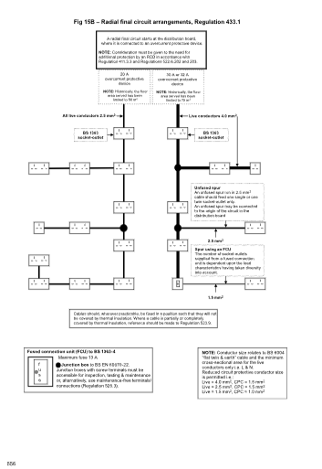

Not quite, one I would use oval conduit with existing plaster so not so much plaster needs removing, but he has missed out all the inspection and testing.

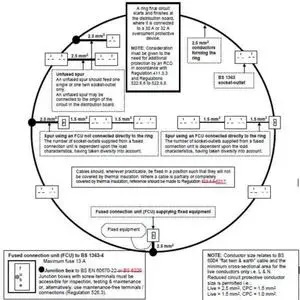

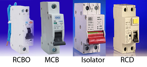

So step one, how many cables go to donor socket? He shows two, so likely part of a ring or radial, not a spur. So these plans Ring final.jpgRing and radial circuits.png show what we can do. So my start would be plug some thing in, and see what MCB/RCBO PartID_CU.jpg controls it. If a 20 amp we are looking at second diagram, if 32 amp likely the first diagram. We have different ways to feed sockets, as part of a ring final, as part of a radial, as part of a unfused spur, and as part of a fused spur. Also looking to see if RCD protected.

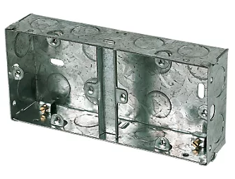

So looking at worse case, one will need to replace the double socket box with a twin socket box, one of these 1714117088864.pngwill allow you to have a fused connection unit (FCU) and a single socket, then feed as many sockets as you want from that FCU clearly total draw is 13 amp, but you are safe, if not already RCD protected then a RCD FCU will do both for the extra sockets, you can use a grid system and the existing twin back box, but you need to know how to wire it up.
If it is a ring final, then you can extend the ring final (two cables) or take an unfused spur, but step one is to test if actually a ring final, and not some previous non compliant work. So you need some form of tester, it could be a battery powered door bell, hence the phrase bell it out.

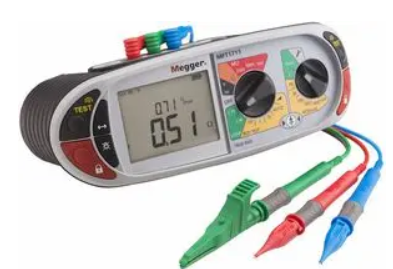

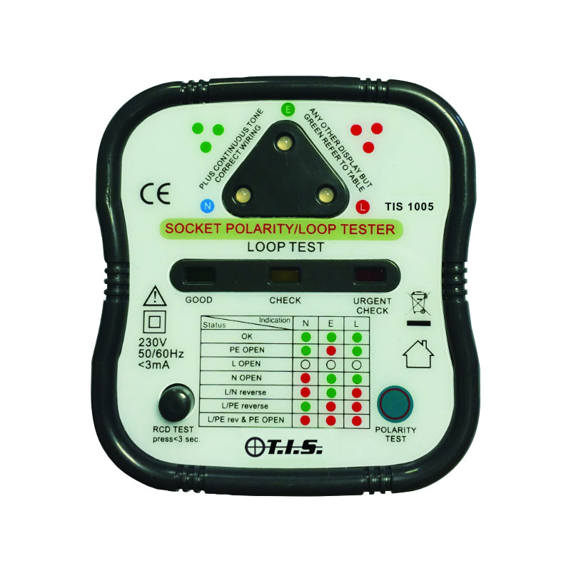

So I am going to jump, one of these 1714117666393.pngcost around £700, you can often hire them, around £70, but I would not expect most DIY people to have one of these, however at £43 these1714117846263.jpegseem to be a reasonable test, they do not test to 1.38Ω which is pass point for a ring, but are good enough for most DIY jobs, but where does one stop? One of these Diffrence line neutral 8 Feb 24 reduced.jpg can test earth leakage, as can one of these VC60B.jpg both cost £35 we are now getting closer to what the full test set does, but getting to the point of can the DIY man use them. As an electrician I returned to collage on a 12 week course at 3 hours a week to get my inspection and testing qualification C&G 2391, I can hardly tell you all I have learnt on a forum.

So step one, how many cables go to donor socket? He shows two, so likely part of a ring or radial, not a spur. So these plans View attachment 341244View attachment 341245 show what we can do. So my start would be plug some thing in, and see what MCB/RCBO View attachment 341246 controls it. If a 20 amp we are looking at second diagram, if 32 amp likely the first diagram. We have different ways to feed sockets, as part of a ring final, as part of a radial, as part of a unfused spur, and as part of a fused spur. Also looking to see if RCD protected.

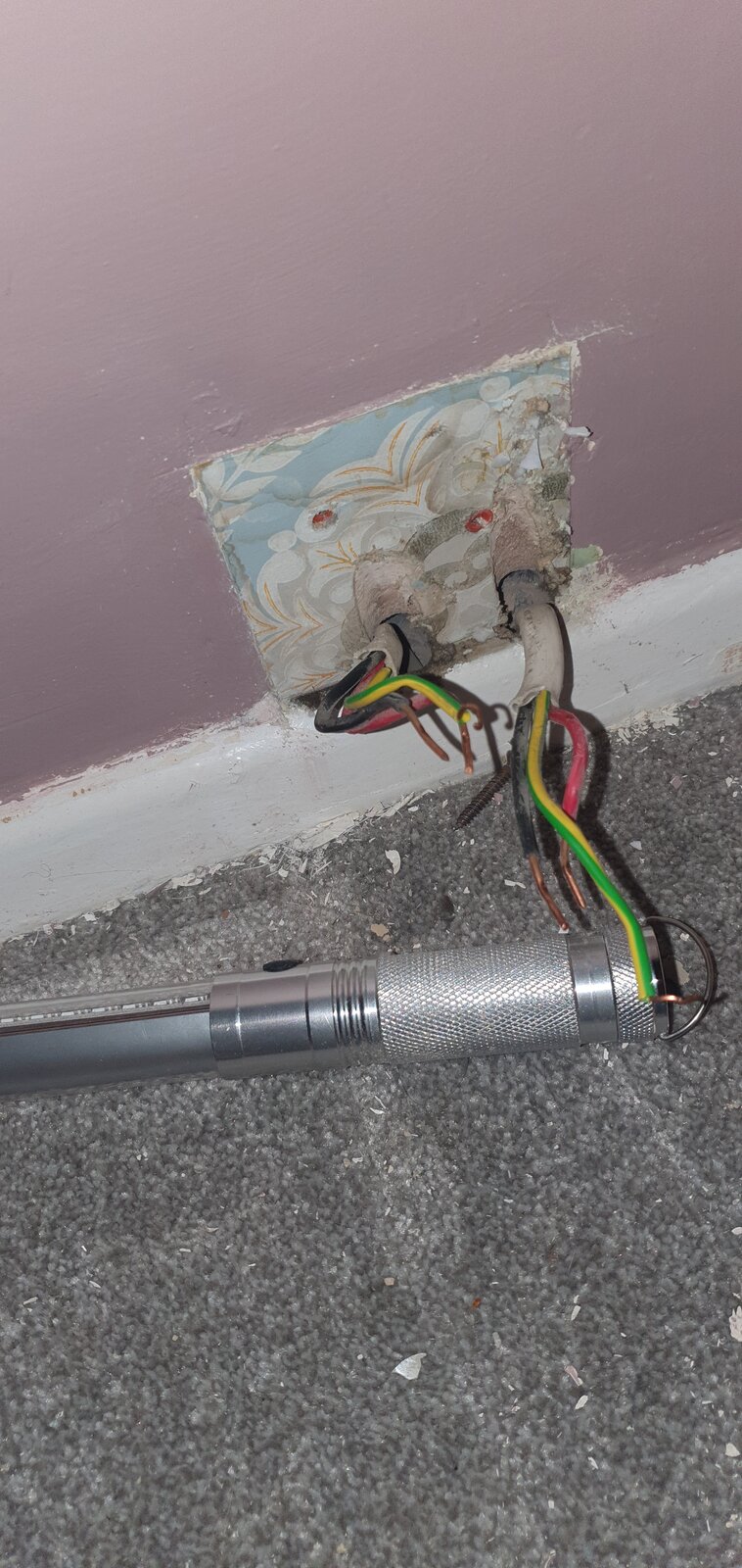

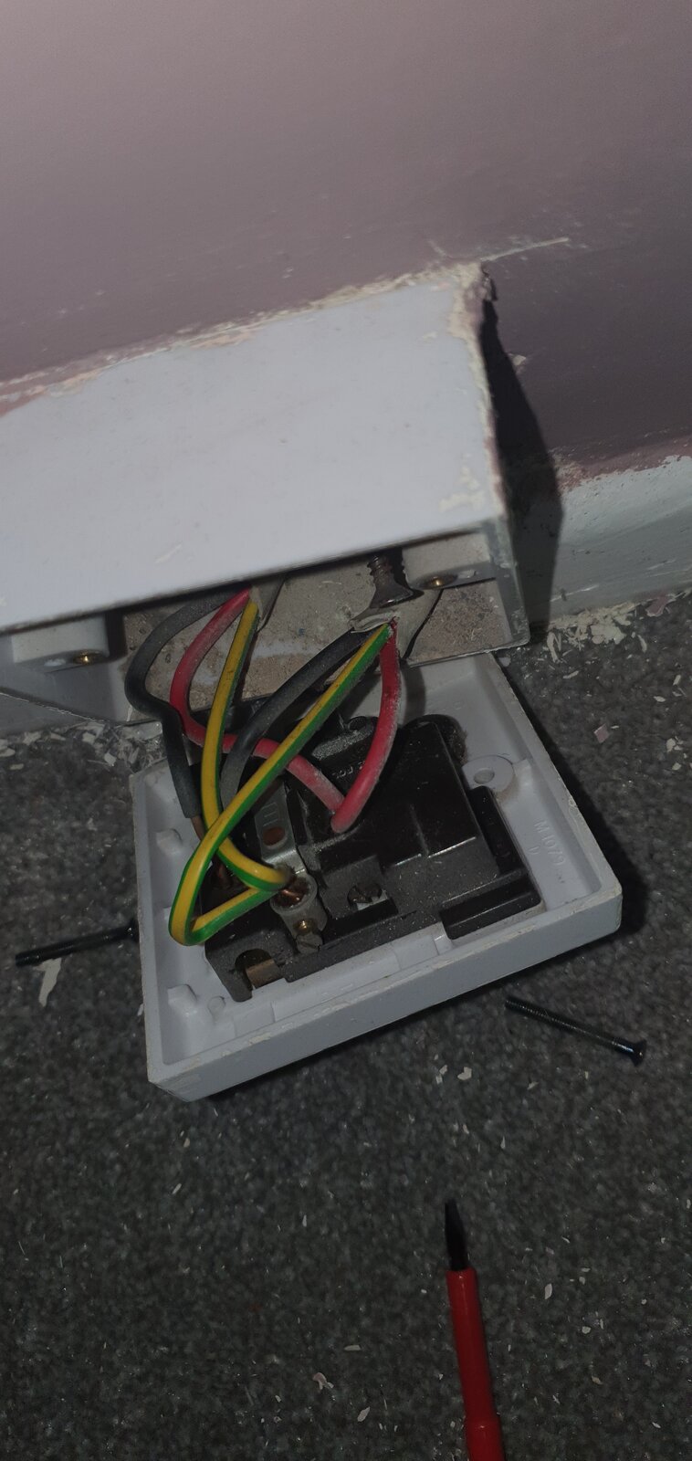

Thank you to everyone Ody who replied. I've read all your replies and thank you for every one of them.
Also, I'm so sorry for the late reply. Sadly my wife was taken ill (She's fine now thank goodness) with a severe kidney infection.
I'll be totally honest a huge part of your very in-depth reply I couldn't understand (My fault not yours lol) so I think maybe it's a little to advance for me. however, I did take this photo of the socket when it was open (we'd just moved in).
As I say though this sounds a bit advance for me at this stage. Thank you all once again

You need a multimeter, set to continuity and check red-red and black-black. If it beeps you're in business.
