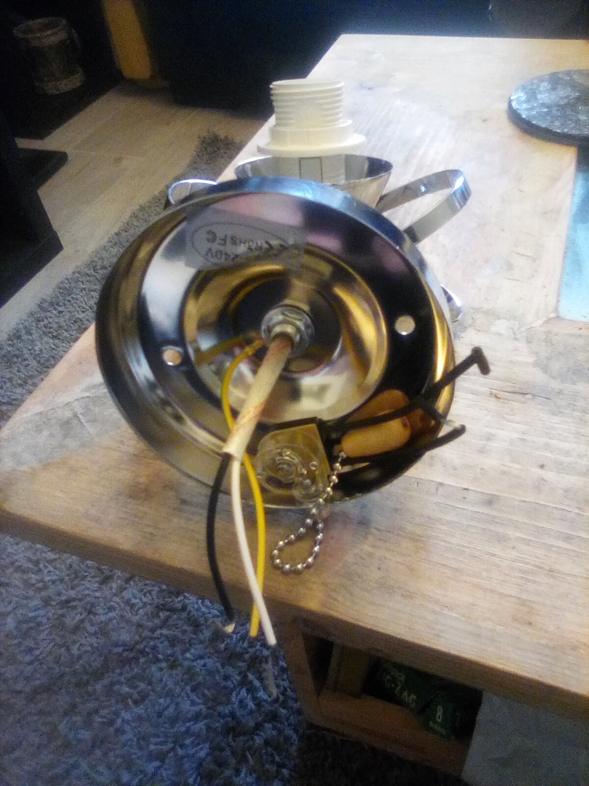

1606394098832114546945421667879.jpg Safe zones ? ( do you mean following the existing wiring layout) sorry just found the post on safe zones I've done a lot of wiring but never wall lights from scratch.plus the actual wall lights have 3 black wires and a white one besides the earth wire.

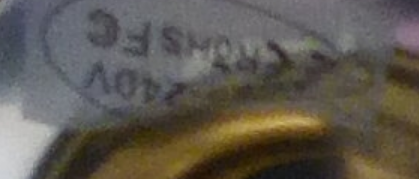

That appears to be an item for the American market where the Live wire is Black and the Neutral wire is white.
It it is an American item then it would be rated at 120 Volts and may not be suitable for UK supplies which are 240 Volt
One Black ( Live ) goes to the lamp with the White. The other two Blacks appear to be from a Switch.
To use the Switch connect BLUE from wall to White in lamp ( Neutral ), Connect Brown from wall to one of the Blacks from the switch. Connect the other Black from the switch to the Black going to the lamp.
If the switch is not being used then connect Brown from the wall to the Black going to the lamp. Ignore the two Blacks from the switch
Cheers for the replys guys on the lamp itself it does say AC85-240V also Thank you for the wiring description most helpfull.

EDIT if you want to use the built- in switch (2 black wires) connect it between live and the black going to the lampholder. Neutral goes to white as @bernardgreen 's accurate description.
