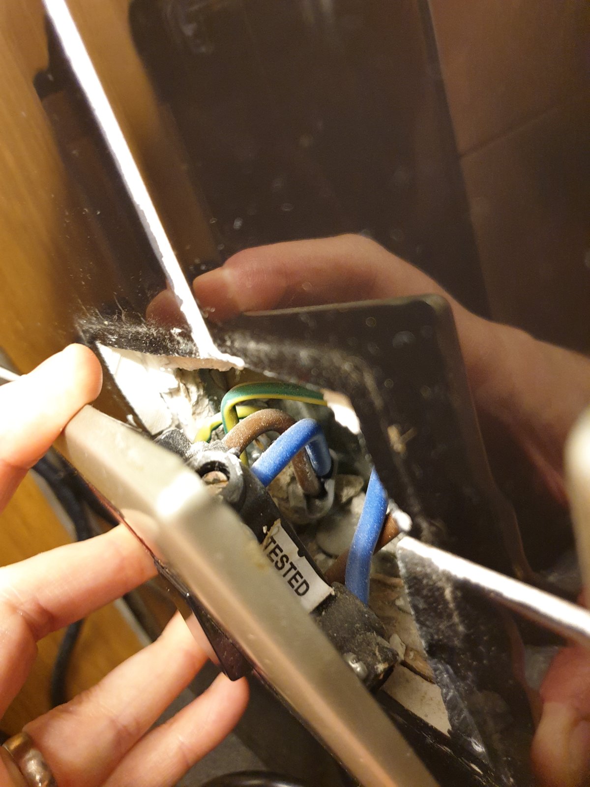

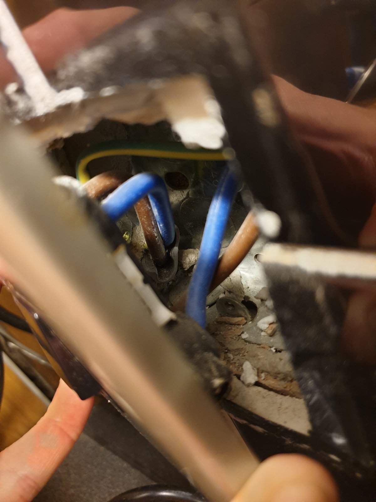

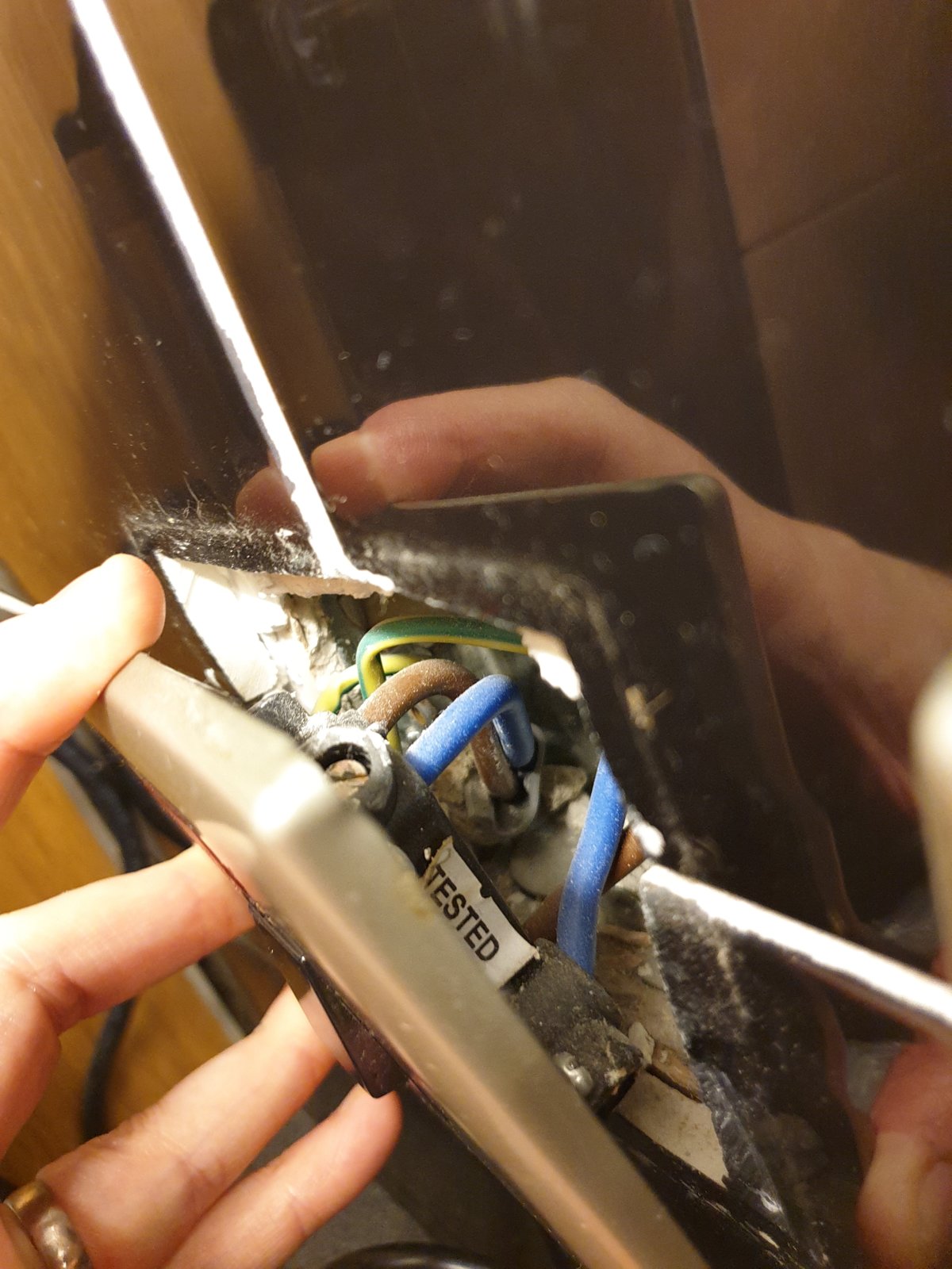

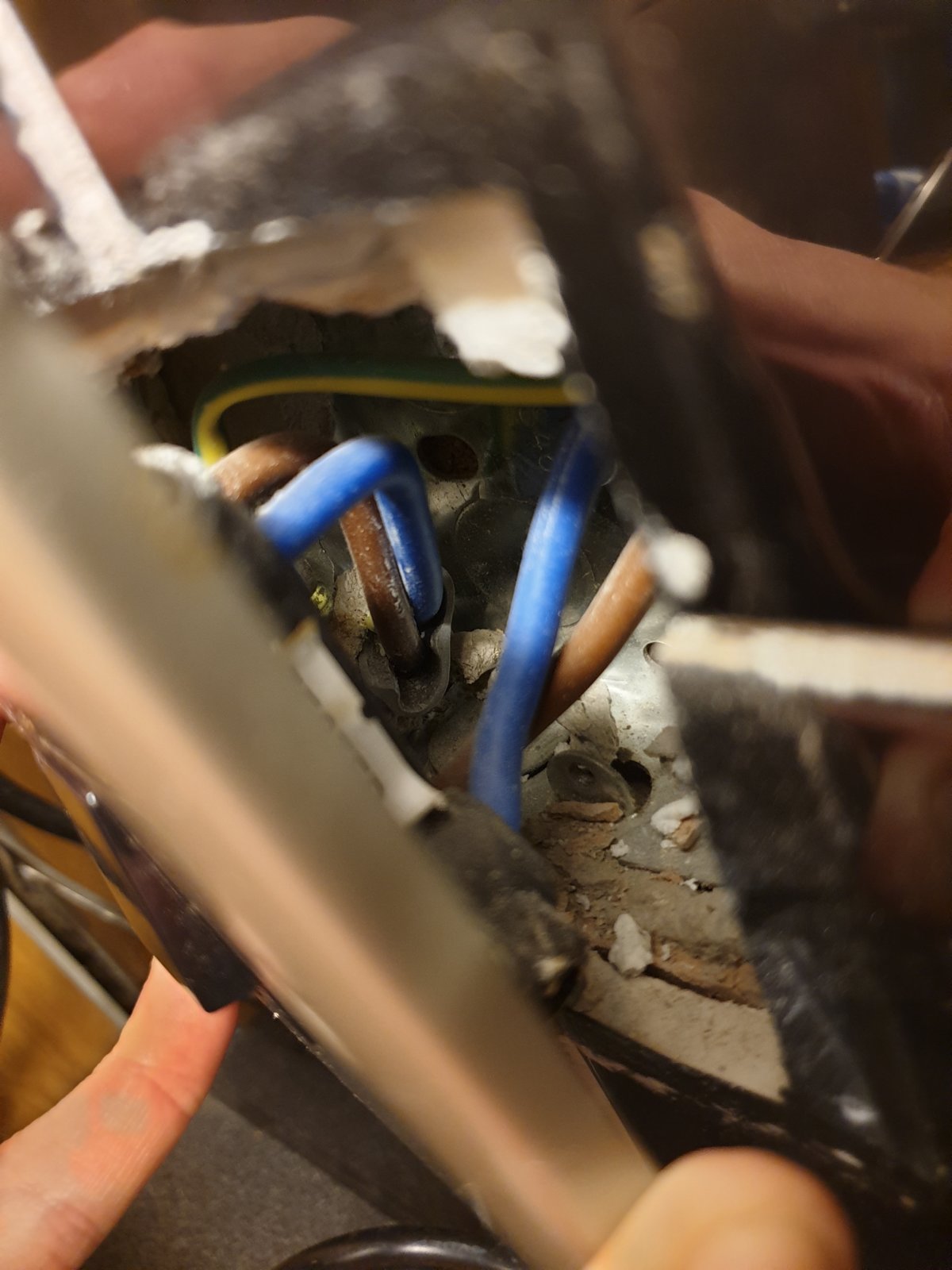

No thermal insulation, it's chased into the wall and clipped onto a joist.
I do know it's heavier cable than what the 13A sockets have but unsure on the size. It's really stiff whatever it is. See attached photo for back of switch on wall.

Yes, looks like it. Maybe someone fitted the 20A MCB for the present oven and it is a 'standard' cooker circuit.
So, 32A MCB will be alright if you have one fitted.
The oven can't draw more than its 24.6A anyway. It will be less than that as not all on at once.
Just one more thing - do you have a socket in the cooker switch?
