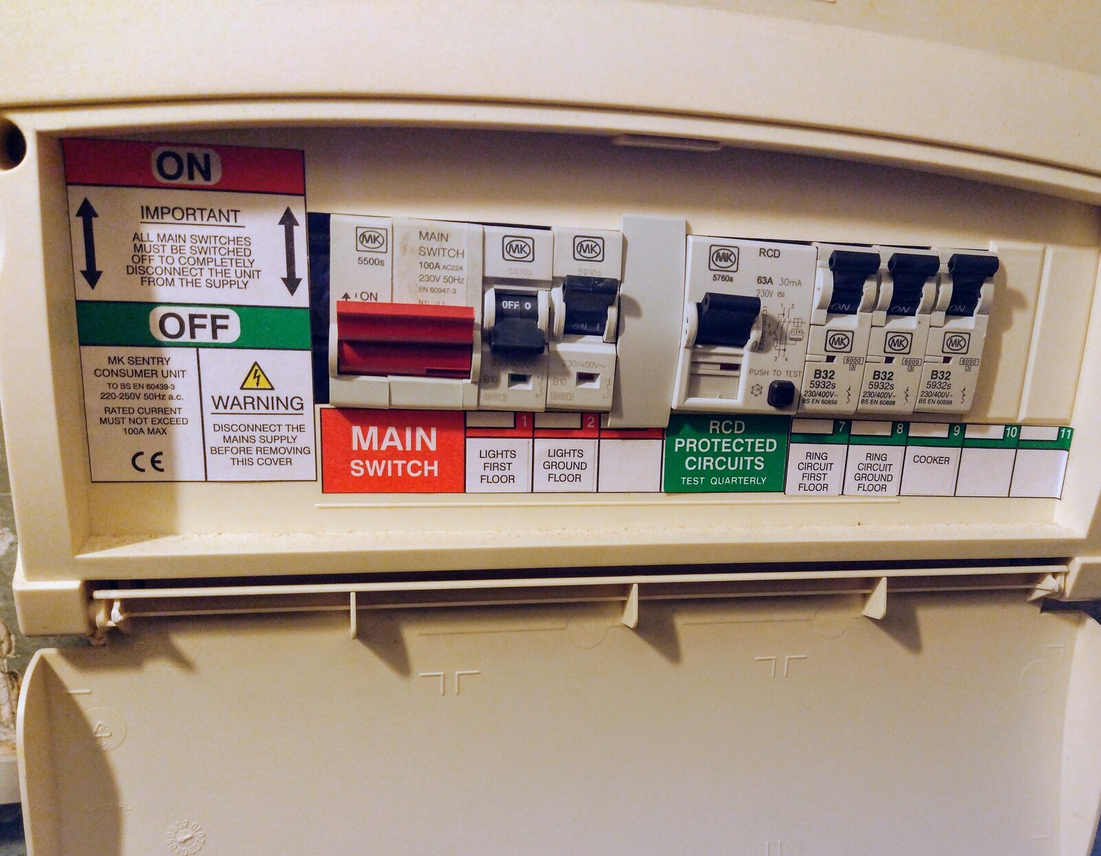

Planning to remove existing MCB's and install 2x RCBO's for the lighting circuit as these circuits currently do not have RCD protection.
Before doing the job I have a couple if queries
1. The other MCB's e.g. sockets/cooker are RCD protected, so can i leave these and just install 2x new rcbo's for the lighting circuit?
2. Can I use a 6 Amp 30mA RCBO - MK (Type A) B Curve
Or should I buy the 10 Amp version as the electrician who fitted the board used a 10 Amp breaker originally?

Maybe you could just move them to 10 and 11?
Not sure that's wise.
If the RCD trips then all of the circuits in the house won't work and finding the faulty circuit will be difficult.
If anything, I guess I could install another RCD
And have one lighting circuit and one ring main on this.. Would be cheaper too.

The first thing to do is remove the cover (power switched off of course) and check there is room in there to take those RCBO's. Not all of the range had space and also the way it's wired.
Do the supply compact versions in Sentry range?
I'd suggest getting a 6A and a 32A for lights and ring.
Main switch, ring, lights, blank, RCD, ring, lights, cooker.

I'm planning to only uograde the lighting curcuits from standard MCB's to RCBO's because currently I have no RCD protection to any of the lighting circuits.
I only found out about this when adding a new light to my uninhabitable loft area.
I will all of the other circuits e.g. Ring and cooker in place as they are RCD protected.
Great shout! Will check this out.
I will have to call and find out. Compact screams pricier though.
Oh are you saying the following..
Assuming there's space in the CU
1. Get 1x 6A and 1x 32A RCBO. Then install this on the left side of the CU.
2. On the right hand side use the existing RCD then put the other lighting circuit here and Bob's your uncle?
If i understood you correctly, can I ask why you favour this method? Clearly it must be beneficial.
