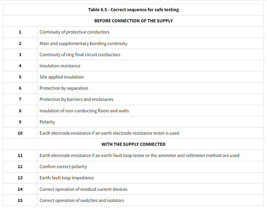

That might not be as easy as you think since, despite my having asked, no-one has yet indicated exactly what tests they would like you to do.
So people are calling for 'testing' but they haven't mentioned what I should do specifically? I really hope this is a joke.

No, it isn't. You said "electrics is easy" so maybe we assumed you already knew or knew how to use Google.
After all. you have been on the forum for twelve and a half years.
I planned to go over the thread and undertake any necessary remedial work/tests over the weekend.
For a start: do your new RCBOs trip within the specified times and current?
I think that was being described as a 'joke' was probably the fact that, despite my having asked on his behalf,those advocating 'testing'did not answer my question about 'what tests?' I wouldn't personally call that a joke,but perhaps a little 'sad' (or, at least,'unhelpful').
Yes,I mentioned that above, but it illustrates the problemi described. Very very few DIYers are going to have the means of testing an RCD/RCBVO, and (even if they knew how to use it and interpret the results) hiring kit for just a single job would not be cost-effective. Di you therefore feel that we should always tell DIYers (other than the tiny few exceptions who 'prove the rule'!) that they should not eveer install RFCDs or RCBOs?
It is such a fundamental thing that if anyone doesn't know what it is they should not be doing more than the simplest electrical work - i.e. DIY work.
Where the possible options are - RCBO installed, but without any testing, or no RCBO installed, because of lack of ability to test - obviously the first option should be the preferred option.
I know 'the list of tests' as well as you do, but on behalf of the OP, I was asking what specific tests might be relevant/useful after one had merely moved two lighting circuits onto their own new RCBOs. As I said, I could think of only one thing (testing residual current performance of the new device)which is something that very few DIYer's would/could do.
