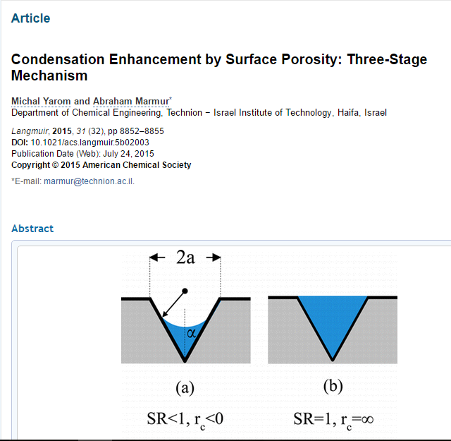

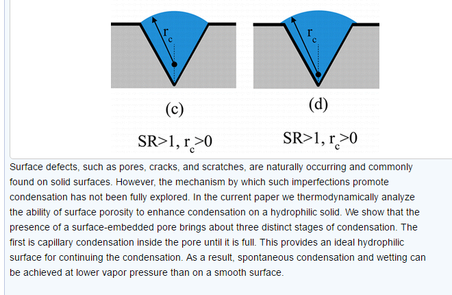

How does moisture (ie condensation) form on the surface of a porous material?

Obviously glass is an extreme case for permeability and I was using that example purely to correct the assumption that it was cold air hitting warm surfaces that cause condemnation.
Clearly as surfaces increase in permeability, the risk becomes lower, but the only fully porus thing in your house is fresh air. But even that can have condensation as that's what rain is.
I'm approaching this from a physics point of view, you're using your experience, which I don't have.
