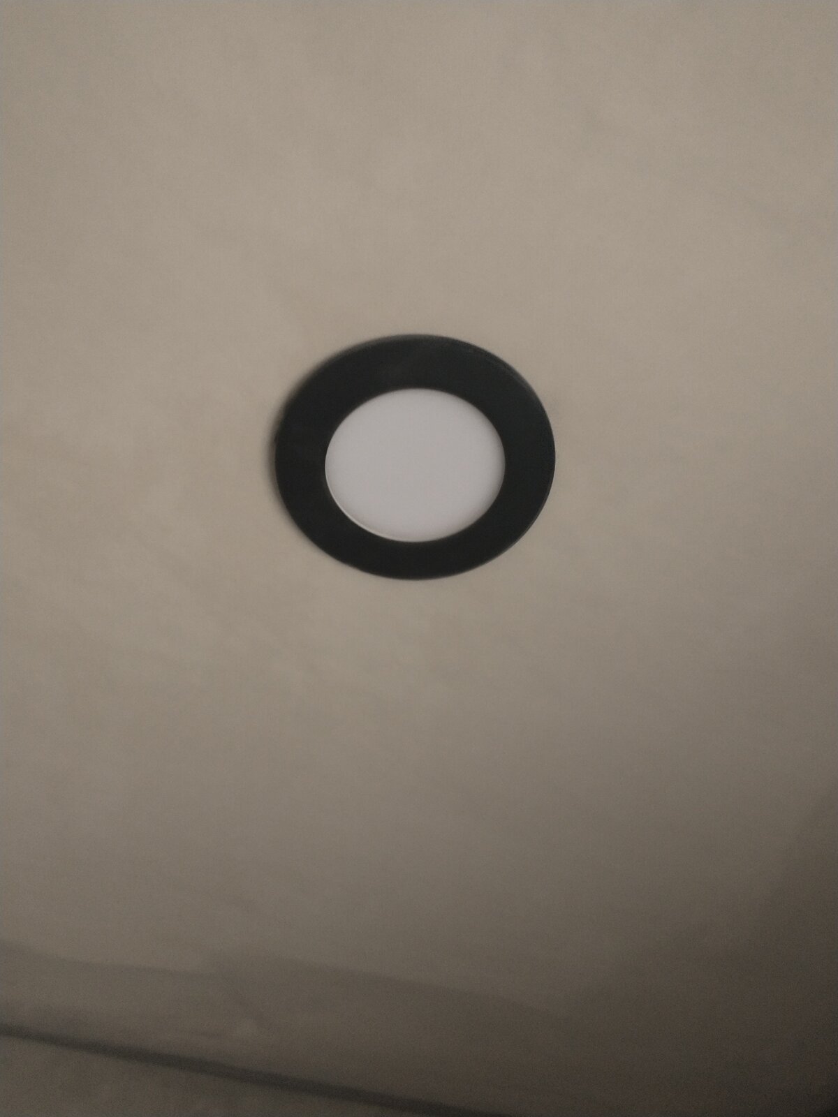

I had my ceiling rose to changed to 4 x 10.5w Monza spot lights. Ip65 in an ensuite. I am painting the ceiling and was to put the spots into the holes myself. What I did notice was the spots where hot to touch and as I have insulation all around the spots, will this cause any negative effects to the spots for overheating. I remember seeing on the diagram it showed them installed into a normal plasterboarded ceiling and not an insulated. Maybe it's nothing to worry about but it is concerning.
Another thing I did notice was draughts around the spots. Before they get installed back into the cut out holes after the ceiling painted, would fire rated silicone be helpful around the underside of them to stick back to the ceiling to stop more draughts/heat lose.

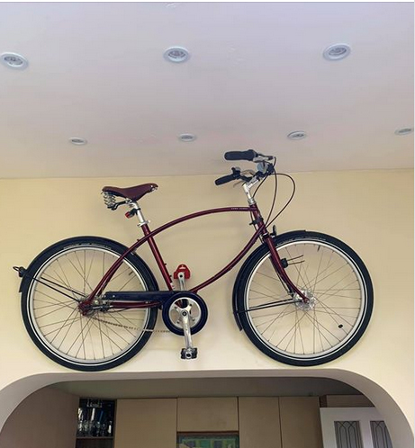

GX53 will allow renewable bulbs, and surface mount, there is simply no need to drill holes in the ceiling today, except for the wires. For a recessed GU10 lamp to work, the ceiling needs to be high, as with this kitchen Kitchen bike.jpg so either well over the 2.25 meters of zone 1 and 2, or not suitable for GU10 recessed lighting.

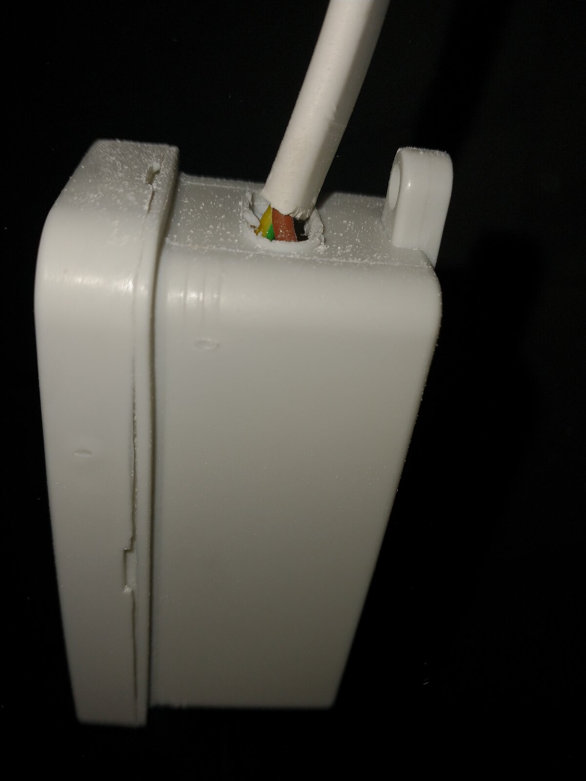

Oh and the junction box with wiring cores showing is clearly not permitted.
What is the alternative to a coffin box thou. The cables are connected to the spots with clip on(like wago) rather than the screwin connectors.

I need to clarify this more. I don't have insulation above the light. There's just a void above it and a room above. The only insulation is what you see in the pic. It's on the sides of the hole. What my concern is with insulation being tight against the light, could it overheat in anyway?

About the coffin box again, why is this not permitted. What other method would be better.

I might just scrape away some of the insulation at the side just to be sure.
