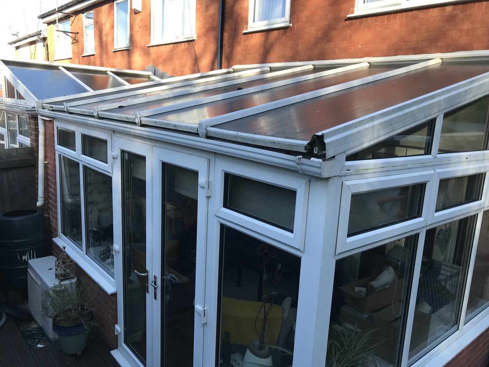

Hi all,
Came across someone who insulated and plaster boarded his conservatory roof. Form his picture it looks to be very similar to ours, so wondering if we can do the same. Had a few ridiculous quotes to change the current opal bronze polycarbonate into white panels for better insulation.

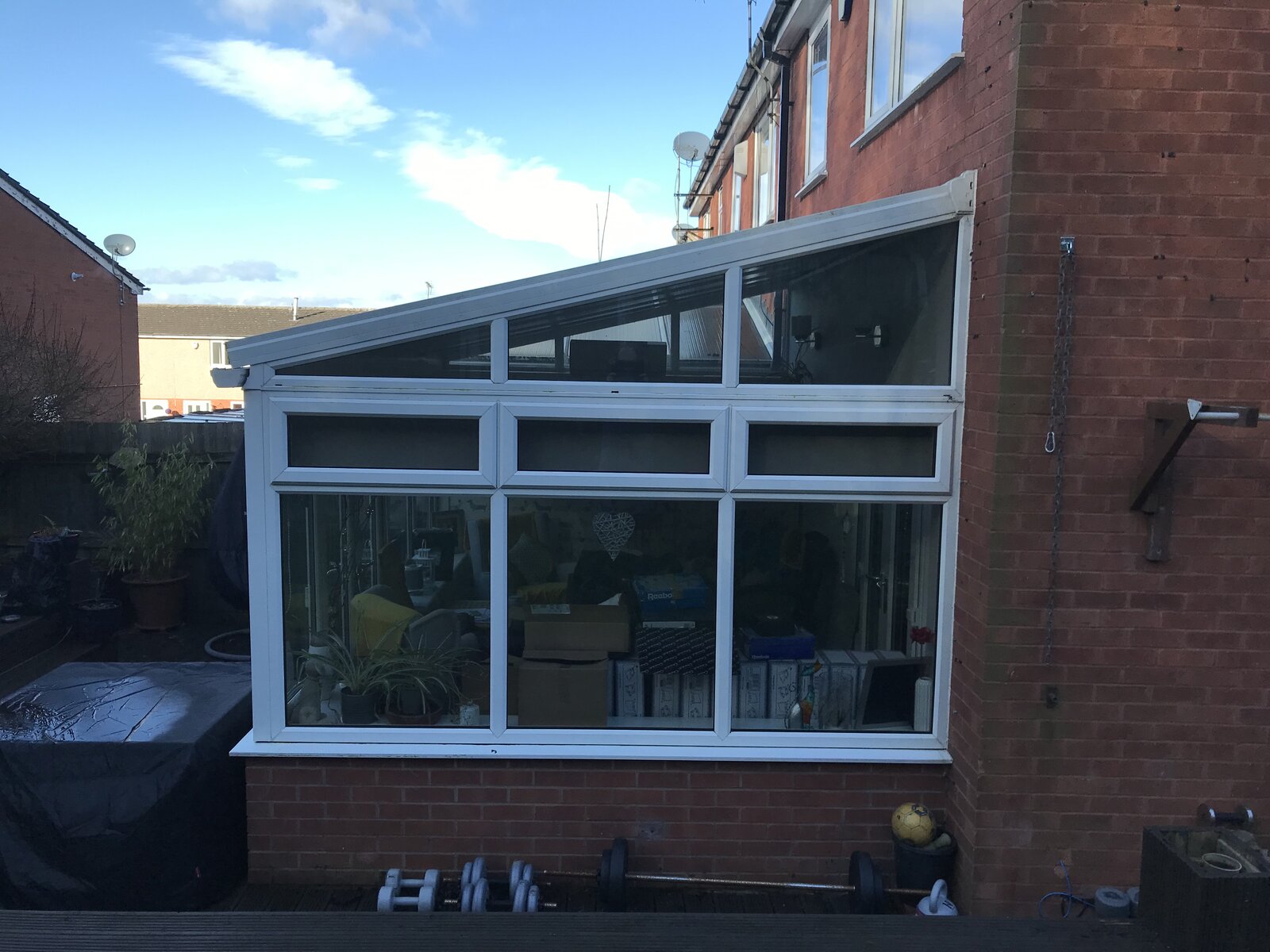

As you can see from the pics it’s a pent/lean to roof, polycarbonate is 35mm, self-supporting glazing bars.
What, truly are my options here to stop it from being freezing in the winter and boiling in the summer? We do have a/c in there, but ya know, want another option.
Replacing the roof with an expensive lightweight insulated fella will help, but won't affect all the radiation from the windows. You may still end up disappointed and £5 - 10K poorer.
We have knocked down and replaced more conservatories in the last 10 years than ever.
