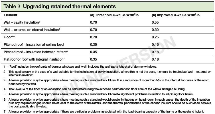

Cavity wall insulation is notifiable to Local Authority Building Control. I think that loft insulation is only exempt from notification if it's not done at the same time as wall insulation. LABC will want CWI to drop the U-value to no more than 0.55 W/m²/K and roof insulation to no more than 0.16 W/m²/K. Look at Approved Document L1B Table 3.
