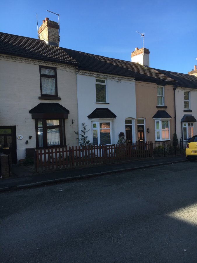

Here's that house .... White one was externally insulated and rendered over.
The upper storey is rendered already. External insulation on the upper storey and a render over the top will not change the external appearance.

@Himaginn - upper storey would be safe to insulate, but as you can see from the pictures, the bottom-half is difficult to insulate.
