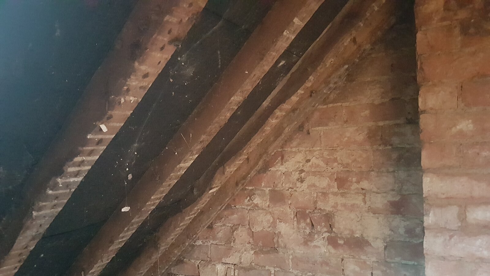

Hi all
We're renovating a loft room (existing, not conversion) and want to insulate between the rafters before we plaster (lime over woodwool board).
I want to use sheepswool insulation, but not sure on how to fit it. The rafters are only 70mm deep, and I understand need a gap between insulation and the roofing felt.
Any ideas on how to get the insulation to stay in place before we fit the woodwool boards?
Cheers
Wide Gaffa Tape?? Every 300.mm / 450.mm up the length of the rafters ?
Ken
