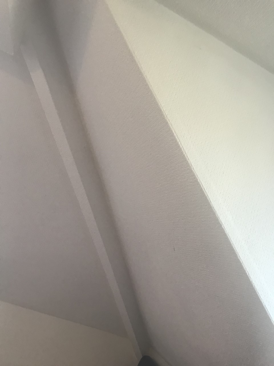

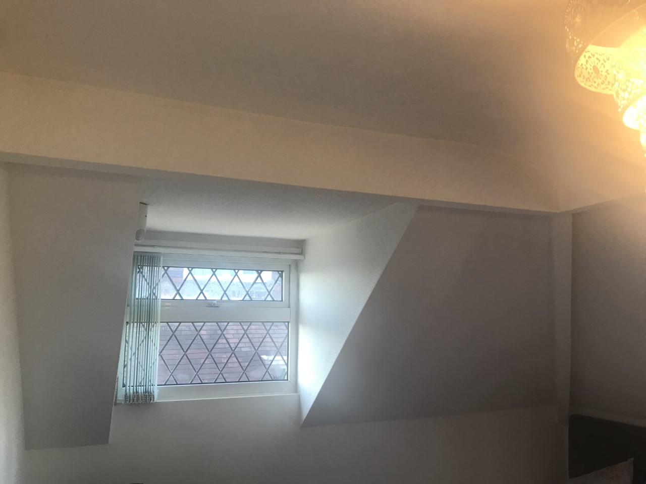

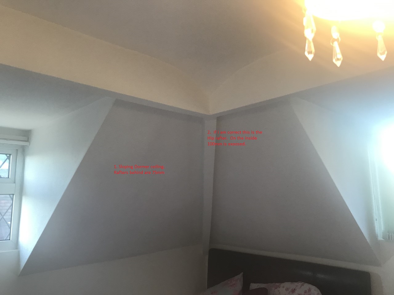

I have added a few pictures of one of the dormer rooms.
On the picture I have added notes, I have 100mm of space between the hip rafter edge and the plaster board, adding to this is the 75mm rafter behind this sloping wall.
If I leave 50mm for ventilation on the rafter and then add 100mm Kingspan/Celotex so the plaster board will more of less meet with the edge of the hip rafter in the room, acknowledge that the I will lose a little room/ceiling space.
or
could I just add 75mm insulation on top of the plaster board that is already there, and then another plaster board on top?
