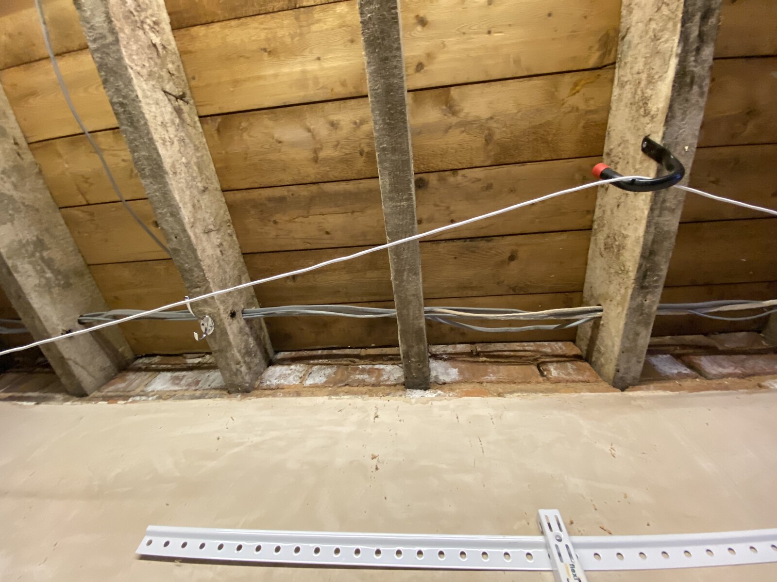

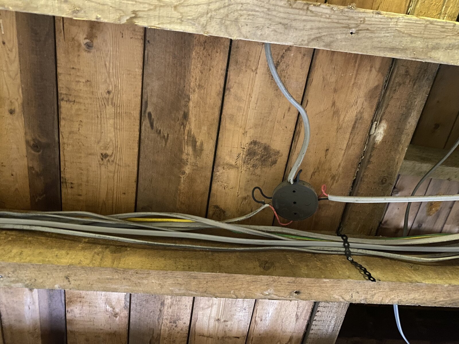

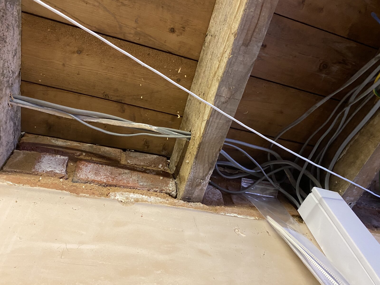

Thanks for the responses. Can I ask how you would deal with the wiring please? Do I just leave those sections empty of insulation? I’ve attached photos. Please ignore the white wire, the grey wiring is what our electrician is currently sorting when fitting the new consumer unit.

You need to speak to your sparky.
Depending on the loads, they maybe able to cope with being buried in insulation. There is a calculation (derating factors) to ensure cables can withstand not being able to shed excess heat
cables should not be buried in insulation. They can lie on top of it, or they can lie on the ceiling with the insulation on top
either is OK.
There is a derating factor for being buried in insulation, so if the cables can take it, it is possible

I’m thinking of just putting as thick a layer of insulation under the joists then board over. As the consumer unit is in the garage, there is wiring going around and out to the house between many of the joists so would be really awkward to insulate around. Not ideal I know.
