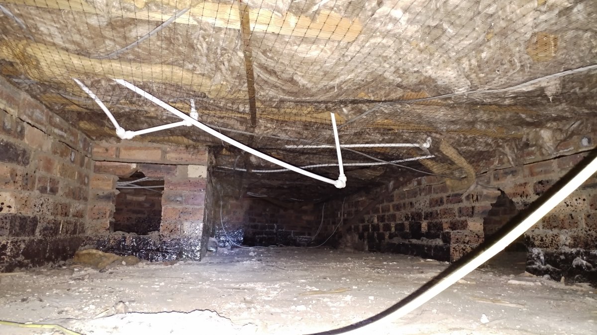

Just had our CH replaced (Boiler, rads, pipes - the works) in our house which has a suspended timber floor. After this was done, we had insulation installed underfloor - Knauf wool between the joists with plastic netting stapled to the joists.
The CH engineer was supposed to lag the pipes under the floor, but he's not keen to do it now as the insulation netting is over the pipes in most places, although the pipes are below the level of the joists. He had ample time to do it before the insulation went in.
As he has used plastic barrier pipe I understand that the heat loss won't be huge, but there will still be some heat loss. I'd say the chances of pipes freezing are remote, but I paid the guy to lag the pipes, so I believe he should do them.
Heating engineer says that there is only a 7 degree difference between the flow and return to the boiler, and lagging the pipes will make this even lower - I am told the ideal figure should be about 11 degrees.
Anyway, my thinking is that I don't want to be losing heat in the ventilated void under the floor!
I would be interested in your opinions on this.

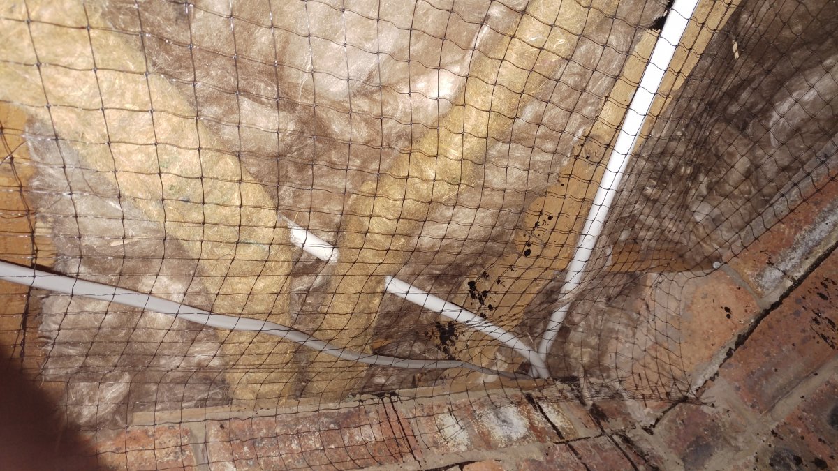

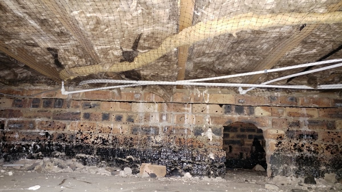

We have a suspended timber floor which has vents all round the house, so it's a cold space. The floor itself has Knauf roll insulation between the joists. Underneath the insulation (i.e. in the cold space, outside the thermal envelope of the house!) we have uninsulated plastic central heating pipes going to the radiators, plus hot water taps in bathroom and kitchen.
My reckoning is that they should be insulated as they will be losing heat - the analogy of mounting a radiator on the outside wall is accurate!
The heating engineer can't be bothered doing it because the netting for the insulation covers the pipes in a lot of places, although the insulation doesn't cover the pipes as they are below the joists. He claims not much heat is being lost as there is only a 7 degree difference between flow and return of the boiler. If this is true then I think this must be some other problem - I do not want to be heating the void under the floor!
So going down the way, we have floor, insulation, CH pipes.

Your underfloor space is much smaller than mine and it doesn't seem to have insulation under the boards - just rememebred I took some snaps at the weekend so I will put some up.
As a rough estimate you seem to have well in excess of 50M of polyipe in an uninsulated floor void. my void at its deepest is about 2/3rds the height of yours. I'd estimate you are losing at least 1.5KW of energy. The risk isn't the pipe freezing its the energy wasted heating pipes that are outside your living space.

Don't let him off the hook this will completely negate any insulation that has been fitted and probably increase your heating costs 10-20%
I'd say 50M is a low estimate - there are 9 radiators serviced on the ground floor. I agree that I must be wasting a lot of heat under the floor!
I will get back on his case and insist that he finishes the job I paid him for!
It makes my blood boil at these so called plumbers (and most plumbers are very good)- but with some they seem to be clueless. mine was a complete ******. I ended up having to redo loads and still had leaks to deal with after he'd left causing me to have to repair brand new ceilings twice.
I'm afraid you've got the equv of two radiators mounted outside your house. If you have a temp sensor take the temp of the flow pipe from the boiler and the temp of the flow pipes at each ground floor rad. You'll then realise how much you are losing.
