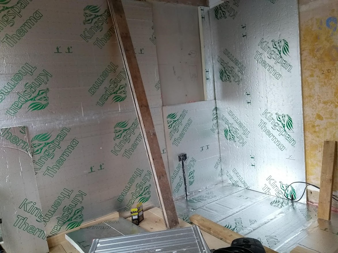

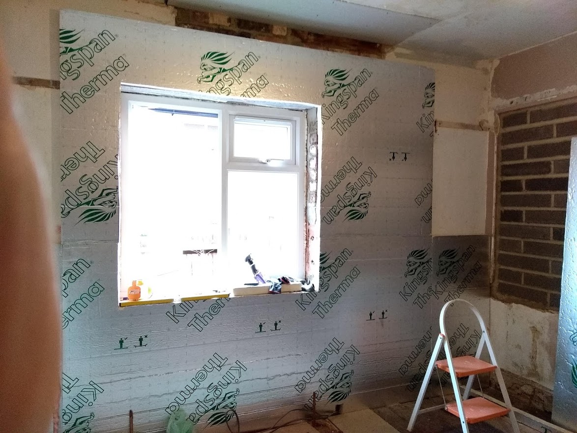

I stick 50mm kingspan boards to the wall with Everbuild dry fix pink foam, then stick plasterboard on this with same foam. Done 5 rooms like this over 3 years, and nothing has fallen off yet!
I've posted here about it, but cannot find my old posts now. Reasons for this approach:
  • easier to work with than insulated plasterboard
  • better vapour barrier
  • more insulation for the price (or cheaper)
Here's a photo - I also did the floor. No more mould, no need to have heating on at night (even when below freezing outside).
and another bedroom, with a window

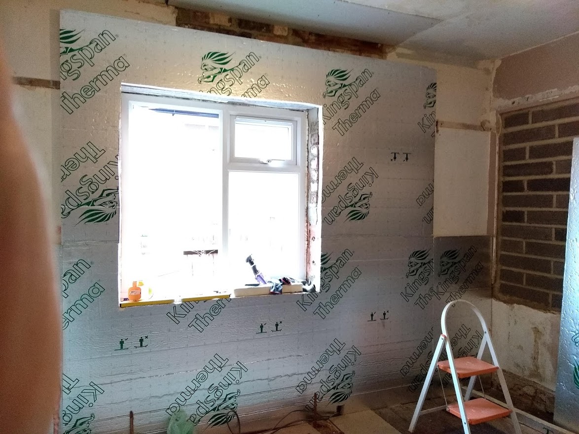

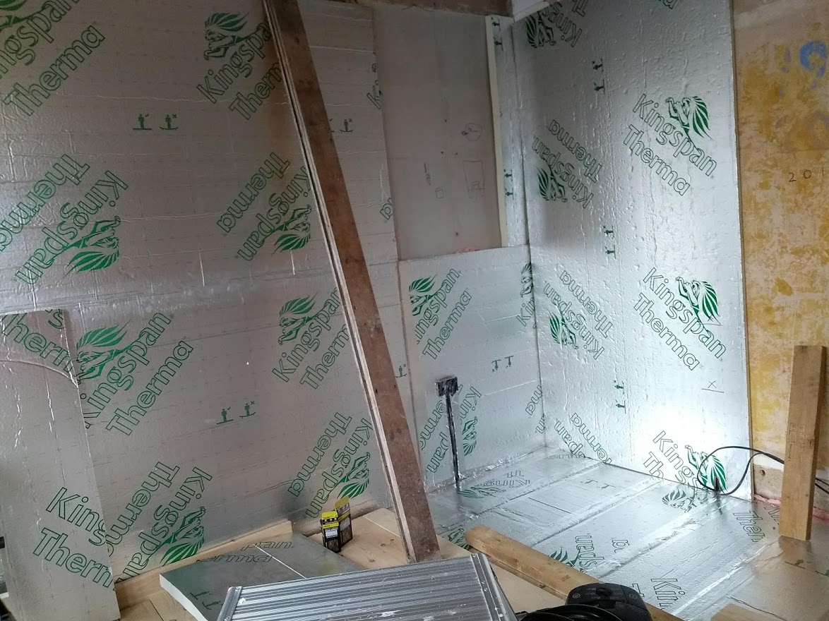

Thanks, looks good. I assume the plasterboard sticks to the foil on the insulation ok? Or do you peel it off first?
Yes, just stick on, don't peel off the foil, that's the vapour barrier.
